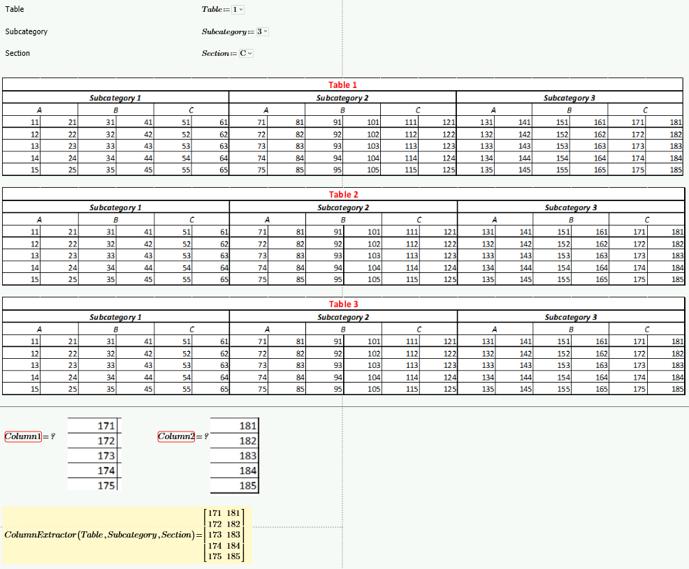

I want to extract a column with data from different tables, where each table contains several subcategorys. See example below (and attached file). Is this possible to do in mathcad?
For example, by selecting "Table 1", "Subcategory 3" and section "C" I want to extract a column containing the right set of data.
Thanks in advance!

Hello @ksk_10594232 , I've attached a solution that should work for you. There may be several ways to solve the problem, but the method I've provided is straightforward to understand and implement.
The attached file may help.
