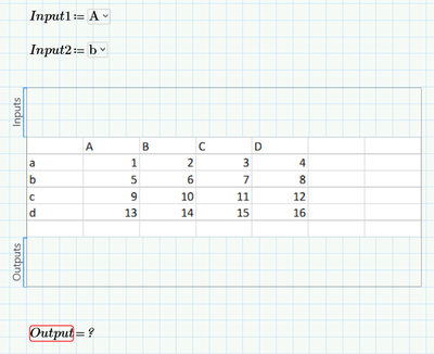

I want to extract a given value from a table based upon two variables. For exampel, by selecting the variables "A" and "b" I want the extracted value (output) to be "5". Is this possible to do?

But you can see in the picture how to do it in Prime. Simply add the "table" output to the Prime Excel component and retype what you see in the picture.
For the solution in Excel I used the Prime input region to get your input values in cells A6 and A7 as you can see in the picture.
I added a formula in cell A9 which gets the row number : =SUMPRODUCT((A1:A5=A7)*ROW(1:5))
and another one in cell A10 to get the desired result: =HLOOKUP(A6;B1:E5;A9;0)
This cell A10 is then added as output as you can see in the picture.
There sure may be simpler and more elegant ways to get the value in Excel - especially when you use a newer version of Excel which already provides new functions like XMATCH.
