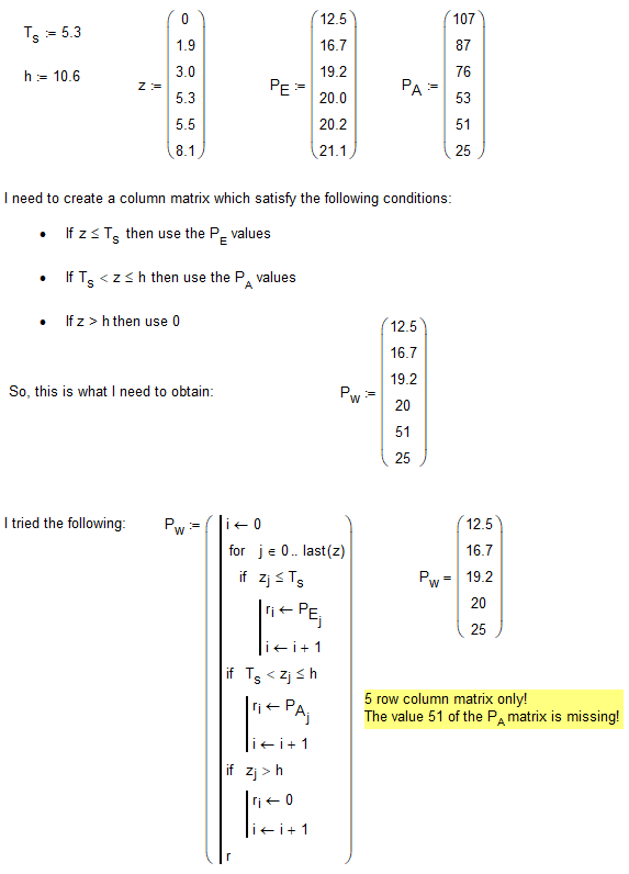

I am trying to extract values from a matrix according to certain restrictions, with no success! In the file attached is the attempt. Any help would be greatly appreciated.

From a quick observation:
You can remove i from your program altogether, and use j to index r.
But the problem lies in the fact that only the first if statement is within the for loop.
I think you want all three if statements in that loop.

Hi.
Thank you, but I think I wasn't very clear. This is what I am trying to do:

Thanks a lot, Luc!
It worked!

You can use the logic operators as follows:

Thanks, Alan. It's simpler this way!
(To:LUBR)
Here are some more ways using vectorized function calls:
