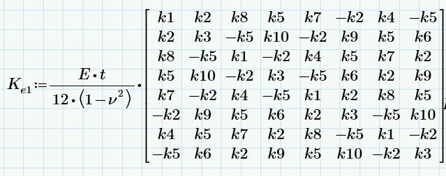

Good day. I was wondering if anyone can introduce a good tutorial and help me on how I can compile the global stiffness of this example problem in mathcad prime. I am currently studying FEA Method and still do not know how to properly mesh 2d into a single matrix. I hope anyone can help me program it. Thank you.

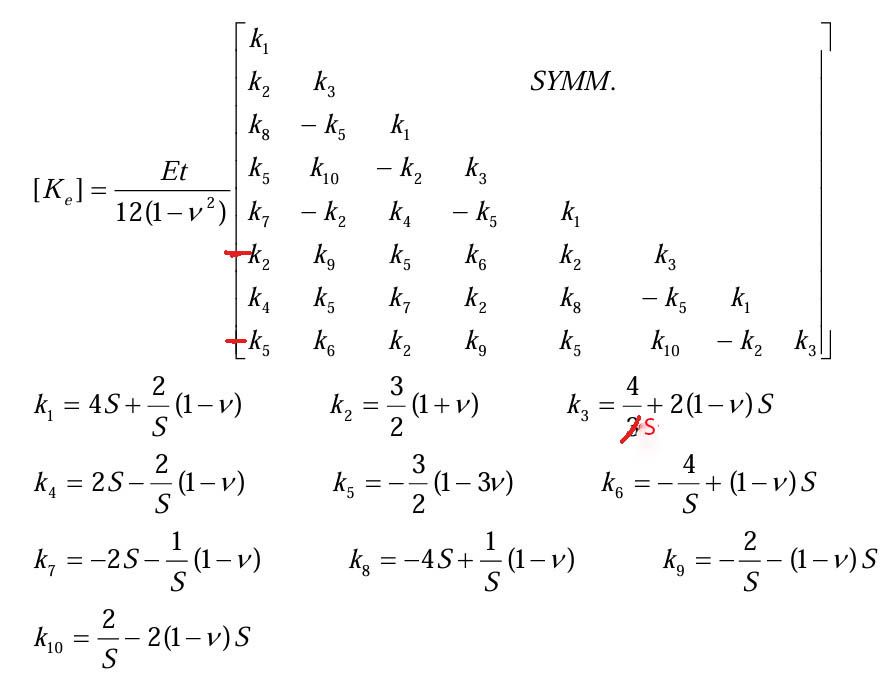

Errata for reference https://sharif.edu/~ghaemian/Finite-Element_files/File/chapter3.pdf that gives erroneous results.
Make three small changes and it works
1> Add minus to k2 in column 0
2> Add minus to k5 in column 0
3> For k3 first term divisor is S not 3.
Cheers
Terry

Here is one way
But it is not giving the correct answer so looking at it

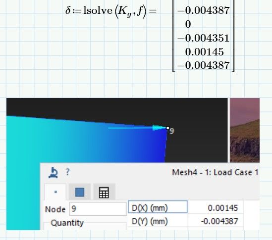

Hi Teddy,
Happy it is now working with a third attempt at elemental stiffness matrix.
