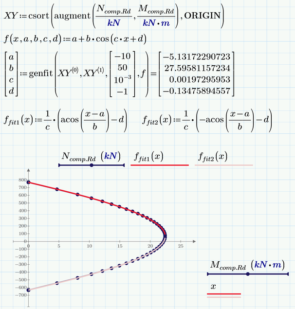

Hi

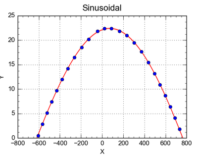

I have plotted the results from two vectors. The graph resembles the shape of a half circle and I would like to find a function that fits the data so intersection points can be determined for other functions.
I have tried many different curve-fitting tools but can't find a proper one that works.
I'm  thankful for any help!
I get slightly different values using CurveExpert Pro
And I get similar values in Prime using genfit() (though genfit is VERY sensible wrt the guess values).
BTW, as we can see far to the right of the Prime sheet how the data is actually calculated it should not surprise that a sinusoidal fit is suggested by CurveExpert 😉

If I digitize the data, then rotate it so X is a function of Y, and send it to CurveExpert,, I get
Which has the form
Prime 4 attached
Wow! Thanks for the good explanation!
Its probably better to use the fitted cosine function itself like Fred had shown instead of the splitted arcus cosine used by me.
You may also add units to your fitting function.
Its also possible to use genfit() with units, but when I tried it showed to be extremely sensible with respect to the guesses, so I think its better to use it unit-less and add the units afterwards as shown below and in the attached sheet.
BTW, why did you "hide" the calculations so far to the right instead of using a collapsed area? See attached sheet.

As in the area of interest for every value of x there are TWO different values for y, it can't be a function because a function has to be unique by definition.
But it was possible to split into two functions - one for the upper and another for the lower part.
Because x=f(y) is a cosine (you may turn it into a sine by shifting for a quarter of the period if you like), the aforementioned functions for the upper and lower part basically are arccos() functions. If you look at my first reply you may notice that the only difference is a sign in front of the acos() function.
I considered splitting into two function not to be very elegant and so picked up Freds approach of using y as the independent variable.
So if you need to calculate BOTH N-values corresponding to a given M-value, you will have to use BOTH function shown in my first reply (I called them f.fit1() and f.fit2() in that post).

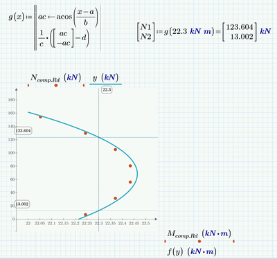

Even if you restrict the calculation to the first quadrant, there is an area at the right end, where you have TWO N-values (y) for a given M-value (x). So there can't be one single function N(M) (or y(x)).
For M=22.3 kNm you get two different values for M (approx. 123.6 kN and 13.0 kN)
You can see this clearly when you zoom in at this position. What you also can see that way is, that the fit of course is not perfect. After all its an approximation and not an interpolation.

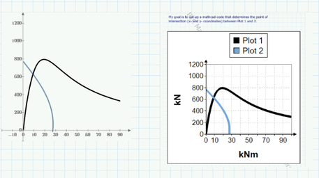

The ultimate goal is to find the point of intersection between two graphs plotted from x- and y-vectors, and apply the solve block function so the intersection can be determined smoothly. I have tested this before but I get inaccurate roots due to, what I believe, is because of non-continous plots? That's why I want to find a function that fits each plotted graph, and apply the solve block function accordingly.
Hope you understand what I'm looking for.
You would have to give a concrete example of which graphs you would like to intersect.
As already written, there is no single function y(x) or N(M) because of the mentioned ambiguity, so you would have to find another way to get what you are looking for.

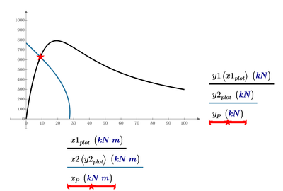

See attached file. I hope my query is clearer this time 🙂
Hope that the attached sheet is of help.
I used linear interpolation, but the same method also could be applied to fitted functions derived by using gefit() or the like.
Your data vectors are not measured data but data derived by calculations.  Your calculations worked with vectors of input values from the start. So it might also be possible to turn the calculations into functions of the input values and use these to find the desired point of intersection. Had not given this approach (maybe the most natural one) much thought, though, as I would mean larger changes in your worksheet. So I just worked from the two pairs of calculated vectors and used linear interpolation to turn them into functions.
Remark: The second plot is still turned into a function x2(y) for the aforementioned reasons. But if you limit the curve to x-values from 0 to about 20, because you know/see that the looked for point is somewhere in this range, you can also turn this part into a "normal" function y2(x) and then solve the equation y1(x)=y2(x).

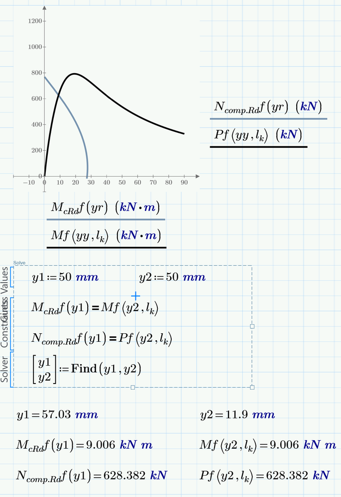

It is possible to define functions rather than vectors for your plots:
I've done it in the attached Prime 8 Express sheet.
Attempts to solve for the intersection (in Express) have failed; maybe someone with a solve block capability?
Note that it's possible to create functions only using the parameter "y", which would result in a single intersection point.  I introduced a second variable (l_k) hoping to be able to trace the intersection point as a function of that variable.
If only one point is required . . .
Good Luck!
Here you are ...
As solve block does the job pretty well but is a bit  sensitive wrt the guess values
