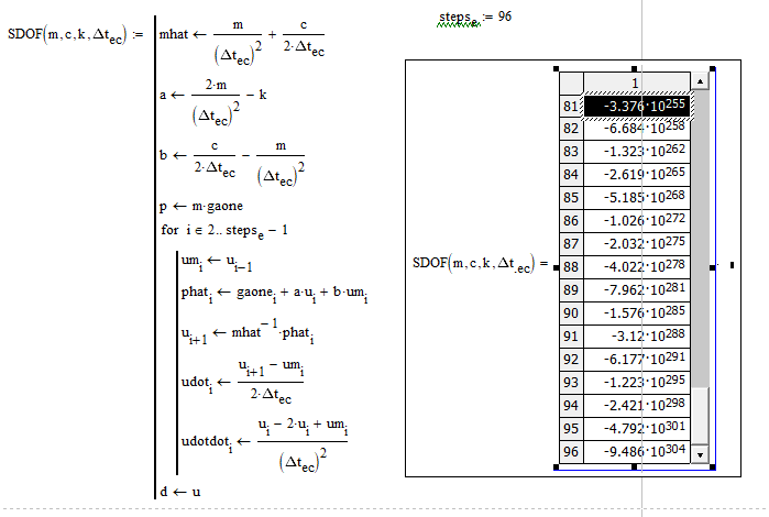

I am coding with Mathcad a worksheet that is supposed to generate the response spectra for earthquake data. I have achieved it using the Implicit Method, but when I use the Explicit Method (Central Difference Method) I get the message that there is a floating point error. Could somene please help me to fix this problem?

The local variable u gets bigger with every step, and at step 97 you get a floating point overflow when calculating phat. I'll also note that udot and udotdot are not used for anything, and could be deleted.
(To:camacogacu)
OK, Richard has beaten me 😉
If i is 96 the multiplication a*u_i exceeds Mathcads limit of 10^307 and throws the error.
You'll have to check the algorithm used.

Thank you all for your quick response! 🙂 I´ll check the algorithm used
