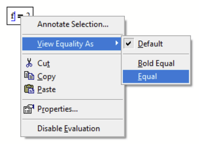

I'm writing a journal article and importing lots of MathCAD equations into Word (.  There's three ways to show a MathCAD equation, colon, control-equals or equals.  Only the equals key gives me a publishable equals sign (colon gives a colon-equals, shift-colon a bold equals)., but I can't use the equals key to show variables on both sides without one of the variables turning red ("This variable is undefined"), or if defined, other problems.
Any ideas?
...Larry
(To:LarryBaxter)
There is a good reason for having different "equal" symbols for different kind of 'equals' (assignment, evaluation, comparison).
But it looks like you are using real Mathcad and not Prime and so you have luck.
You can change the way an assignment/definition is displayed to a normal equal sign by using the right click menu
The same goes with the comparison/Boolean equal
You can make these settings on a region per region basis or global for the whole worksheet via Tools - Worksheet Options - Display:

Works!
Thanks very much...
