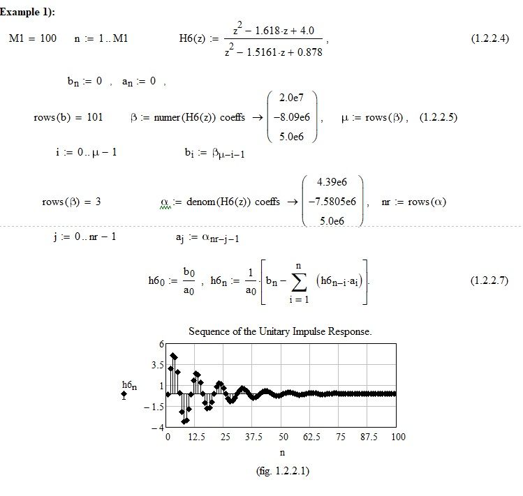

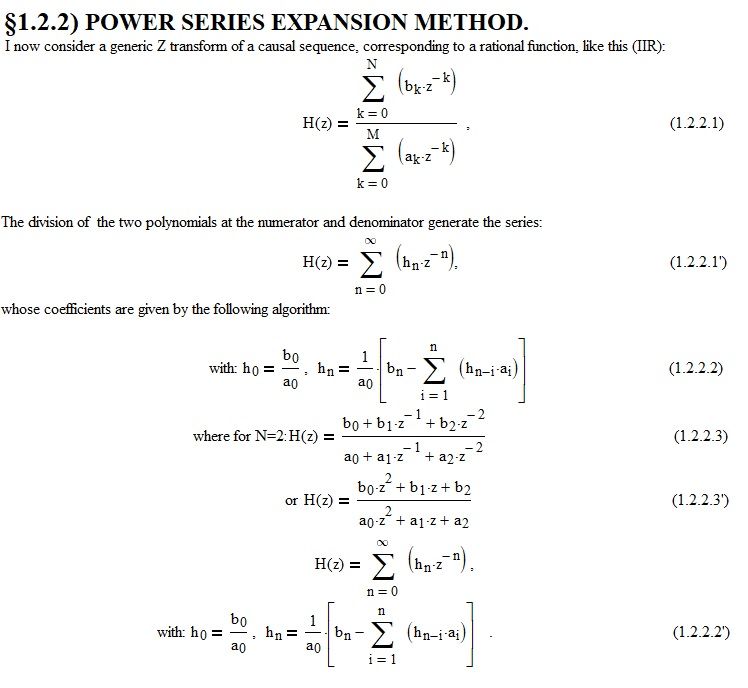

the following two photos illustrate the algorithm of the synthetic division and an example (you have only to change z with s):

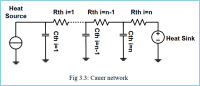

Are all your filters the same size (Same number of R's and C's, same topology)?
Yes they will be 5th order Cauer networks like this:

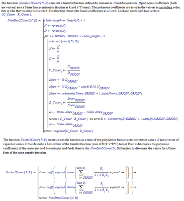

LucMeekes
(To:Anselme)
Hang on a little more.
It's not completely lost, even for Mathcad 15.
Note that the function NUmDen2Cauer, which does most of the work, does NOT use symbolics. It just needs the coefficients of the Numerator and the Denominator polynomes. How it gets it (or, how you get them in there) is another matter. In my (Mathcad 11) case it is essentially what Foster2Cauer does, just before it calls NumDen2Cauer.
Most important at this time is to find the error that is apparently in NumDen2Cauer. I didn't find it yet.
For implementation of that function I used this source: https://nl.mathworks.com/matlabcentral/fileexchange/48042-foster-and-cauer-equivalent-networks (under the "Function" tab). I'm not fluent in Matlab: I may have made a mistake in my implementation, or there is a mistake in that algorithm.
In the file attached, I tried to write the program and if fails when I insert the command to extract the coefficients:
Attached is the same file but saved as MathCAd 11

LucMeekes
(To:Anselme)
See if this works better.

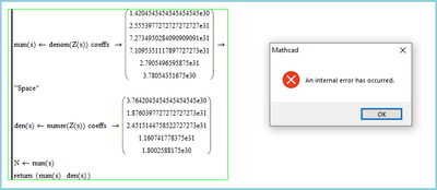

Note: You ARE able to get arrays with the coefficients of the numerator and the denominator. That should be all that is required. As I said. The important work is done in the NumDen2Cauer() function, which only requires the two arrays with coefficients...
Hi Luc,
This produces an internal error:
LouP
(To:LucMeekes)
Luc,

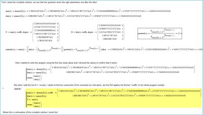

I think that all the math in your function NumDen2Cauer is correct. Also, the submatrix operations throw out the terms that are expected to be zero, so any nonzero residual value from incomplete cancellation doesn't matter. This function and my implementation agreed in all cases when given the same coefficient vectors. To be completely general, you could allow for the cases 1) that have an input resistance & no shunt capacitance, resulting in num and denom polynomials having the same order. The routine as is doesn't allow for this. Need to jump to the R calc as the first value calculated, then resume with C-R-C-R..., and 2) where there is no shunt R at the end (DC open circuit, or Rend = infinity). In this case, the den polynomial has zero constant term, so Z has a pole at s=0.
The calc errors come from the symbolic calculation of the num and denom coefficients. I set up your symbolic function which just returns the coefficients, and did not include the NumDen2Cauer function. Strangely, for cubic or higher order polynomials, the set of coefficients for a polynomial is correct, but they appear in an incorrect order - they are permuted.
I played with splitting up the symbolic calc, and wound up with a sequence I call step-by-step symbolics (see images). This worked for all the examples I tried, up to the eighth order example. In the image, the errors for a third and fourth order terms can be seen in the one step calc, while the step-by-step symbolics and my numeric calc give the correct answers.
One observation concerns me. Using the real (decimal) values of the eighth order example, the symbolic coefficients get quite big, ~10^85. I guess that the symbolic engine is converting the real numbers to rational fractions and working from there. I have found a few simple decimal RC inputs for which the coeff calc didn't work at all.
The v11 file with the new examples is attached.

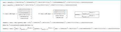

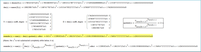

Hi Luc,
Is it possible that your result goes off because the subtraction
does not cancel completely the largest exponent.
I had that problem and here is what I did:
LucMeekes
(To:Anselme)
Could be.
The statement is my (Mathcad) implementation of the Matlab: Nnew = N*D(1)-[D 0]*N(1);
It would mean that the source is incorrect...
Thanks!
Luc,
I don't think the source is incorrect.
In the highlighted line, I calculated the reminder and the s^5 should have go away but It didn't because of floating point residues. In the next line, to work around, I used the s^5 of the numerator plus the denominator minus its s^4 times the quotient, in the calculation of the reminder.
I thought that maybe the same thing happened in your file at:
