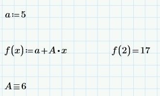

This is for Mathcad 15 although I would like to apply later to Prime 8.0.  My goals are for all of the boolean variables to be active for all portions of the sheet.  I want to defeat the top-down, left-right programming in the sheet.  See attached.

Mathcad takes a first pass through the worksheet.  Global variables are created in this pass.
A second pass through the worksheet creates other variables.
In the first pass global variable TR is created but it has as part of definition a normal variable ZIP that won't be created until the second pass.
Mathcad throws an error

A global assignment can only use constants or other globally assigned variables or functions. A global assignment CAN NOT USE variables which are defined using the normal assignment operator := even if the variable is defined in front of it.
Thats the reason for the error your got.
Terry tried to explain the reason for this behaviour. The sheet is first read by Prime from top down  only looking for global assignments. Normal assignments are ignored in this first pass (hence the error). Then in the second pass the normal assignments are considered and stored. That way its possible that a variable which is globally assigned can be used even in front of its actual definition.
To make your approach with the global assignment work you would have to also globally assign the variables Z1P, etc. which are used in the definition of TR. Not sure what the benefit of doing so would be, though.

Of course you can do this with global variables.
What you cannot do is use a normal variable in the definition of a global variable because the normal definition does not exist until the second pass through the file..

I see what you are doing.  And if I employ that same method and order in my boolean equation, I don't get and error.  But I don't get a result either.  See below
Get rid of the parenthesis and also post the Mathcad sheet rather than just a picture.
YES!  Getting rid of the parenthesis allows the equation to work with the global variables.
