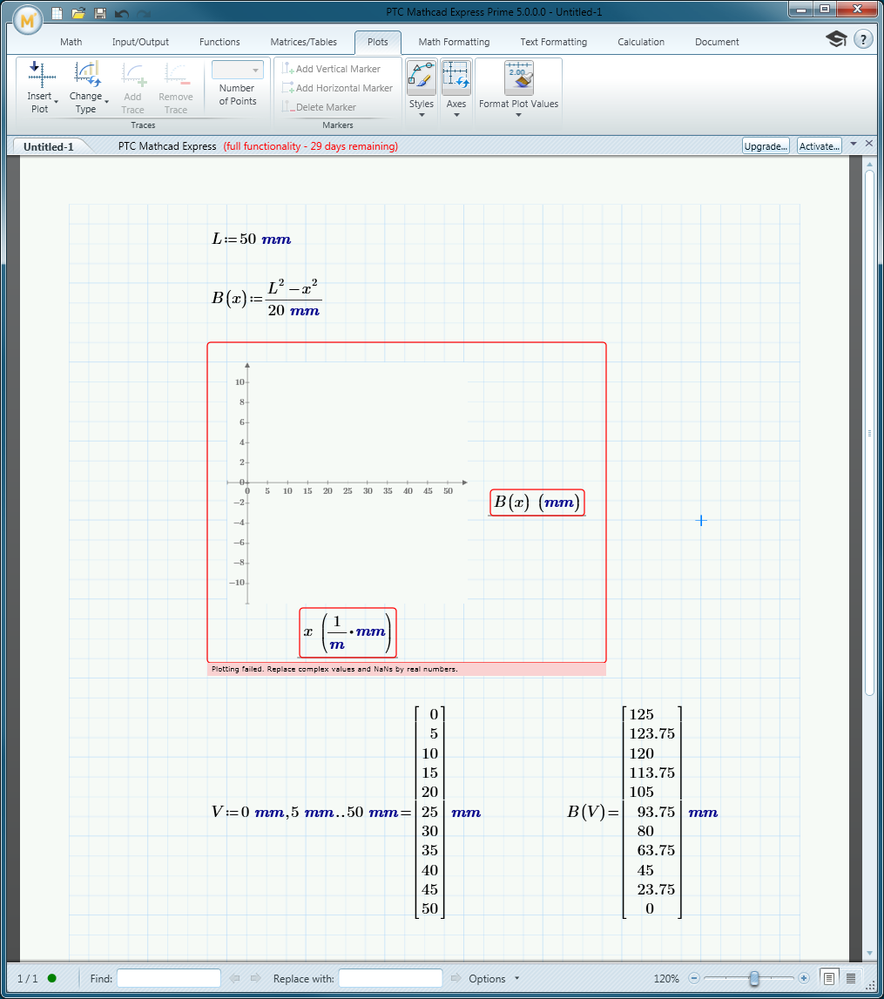

I'll leave you with this image of my 10 minute random experiment of MP5, after which I finally had to give up on it.

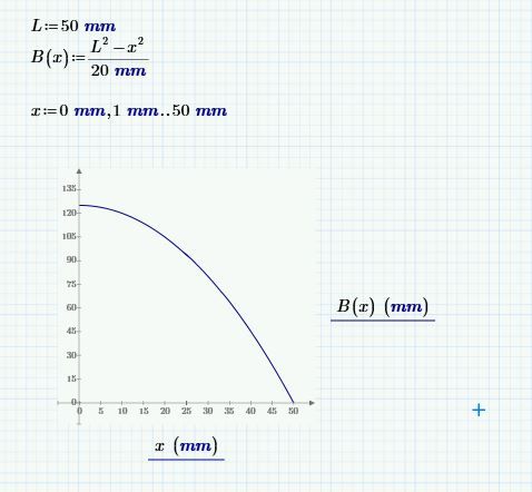

I use MathCad Prime since one year. Previously I used MC 15.
I'm a mechanical engineer and I've not the necessity to have a lot of particularly functions, but I use very often graphs and the main difference between MC before/after Prime, is that you have to specify the function dominio (with units) BEFORE you add the graph.
In my opinion, the new way is better.

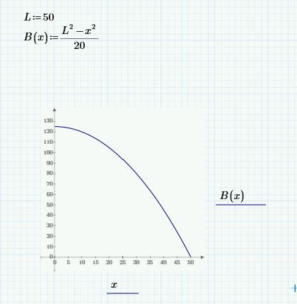

I don't think I disagree with anything you've said.  But I still use it as it is the best available tool for most of my jobs.  I'd think Maple is probably the best overall, but I don't have access.
That said, all you need is a range variable defining x to make your plot.  In some cases MC will default to -10 to +10 but sometimes it doesn't.  I know in other threads this was pointed out as a bug.  But I pretty much define a range every time I plot.

If you don't use units you can make a plot witout a previous dominio specification. Otherwise, with units, you must specify the dominio with units.

I agree that Prime is a piece of junk which probably would never be developed to live up to the more than 10 year old Mathcad 15 and I also agree that it would be be an unforgivable mistake to recommend a young engineer to learn and use Mathcad or Prime.
But to be fair it must be said that the problem in the plot example you showed sure is not a reason for bashing Prime (there are countless other reasons to do so, though).
Your plot example would fail in good old Mathcad 15 and below as well and it just shows a misunderstanding of Mathcads/Primes quickplot feature. This feature where you do not have to define the variable on the abscissa only works for dimensionless abscissa variables. No change from old Mathcad to Prime.
So to get the plot you expect you may either define the abscissa variable (possibly as a range with unit) or use the dimensionless variable provided by the quickplot feature and assign it the needed unit when calling the function to plot by writing B(x*mm) in the ordinate placeholder (this was shown by @gfraulini for Mathcad and it works the very same way in Prime).
So you may blame PTC for not improving the quickplot feature to work with units, too, but in this case you can't blame them for making things worse than they used to be. Prime is so much worse than Mathcad in so many other cases but not in this one.
