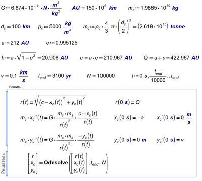

I have one solution of this problem
Great Comet of 1811 - Wikipedia
But my solution is in XY-coordinares and a nee in polar coordinates.
Help please
See pictures and the Prime 6 sheet

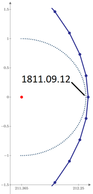

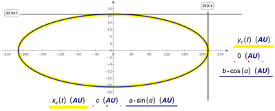

More interesting picture and Prime 6 sheet. Can you point Earth here?
Here's a different way of looking at this (ODE's already solved analytically, as it's a two-body problem).

Thanks, Alan.
But the numerical solution more simple for the undestending.
And...
Solution without animation is not solution
