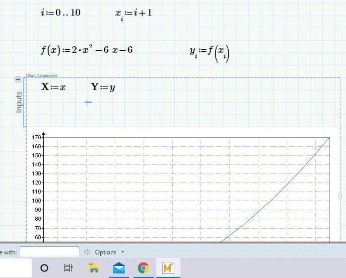

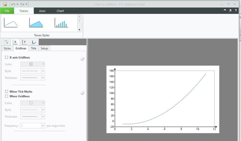

On the ribbon under Math | Regions | Chart Component is a drop down list, select Insert chart component.
Set the x and y values you get a plot.
Double click the plot opens up a whole plot editor where you can set X and Y gridlines.
Cheers
Terry

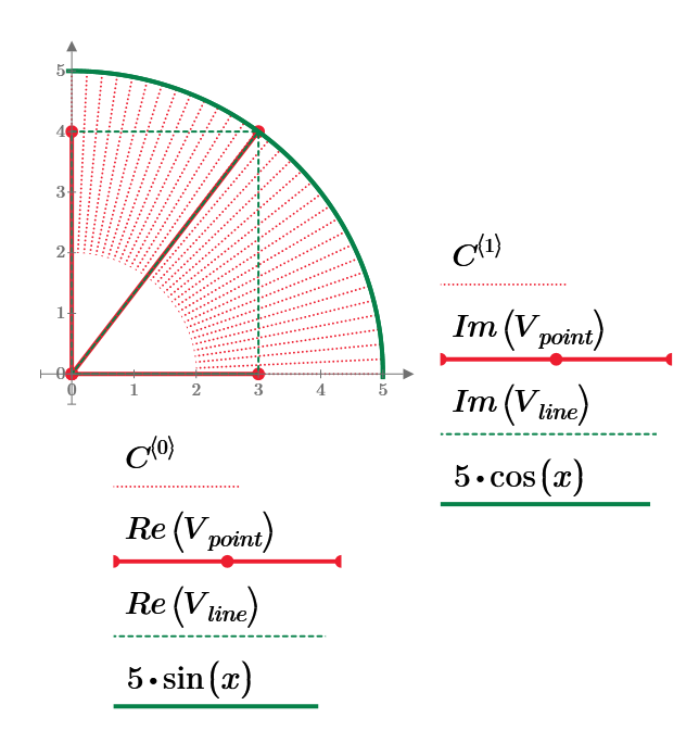

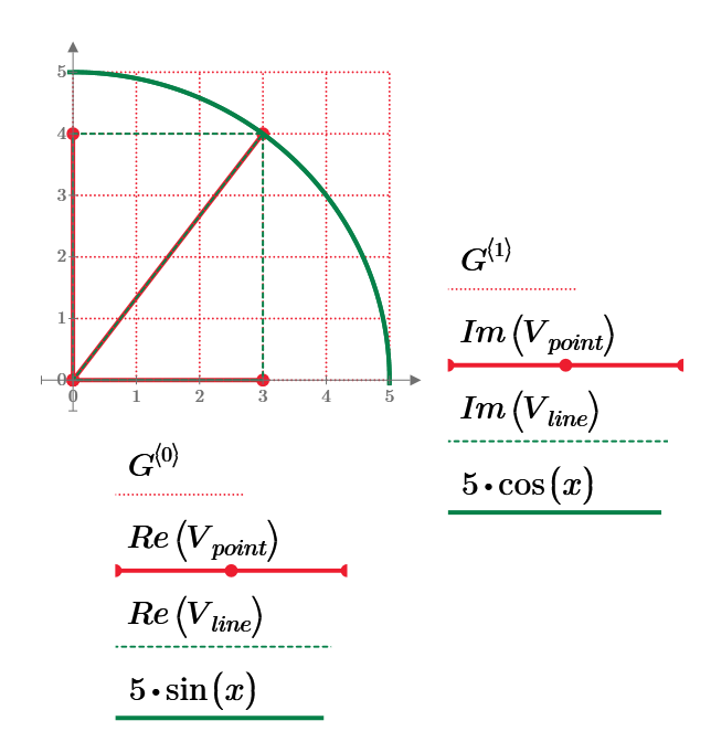

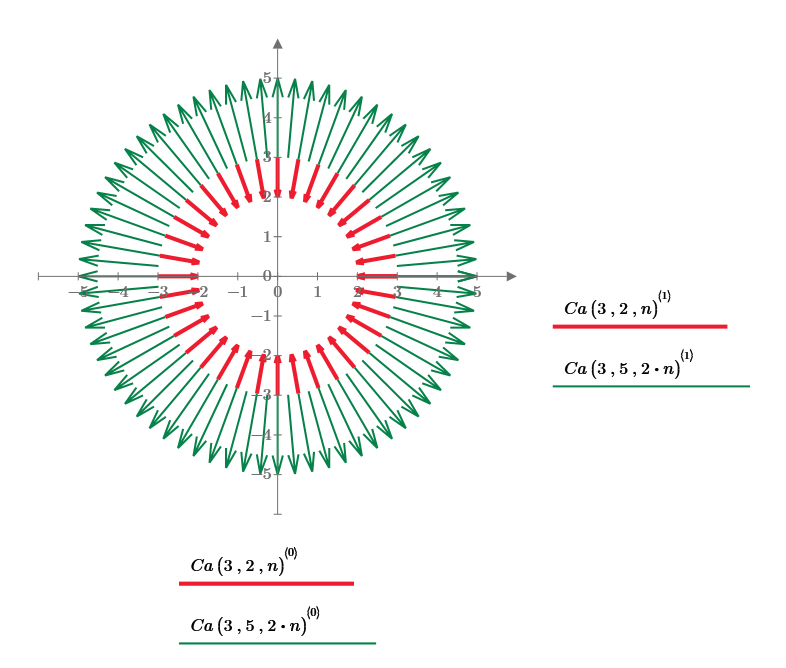

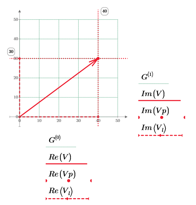

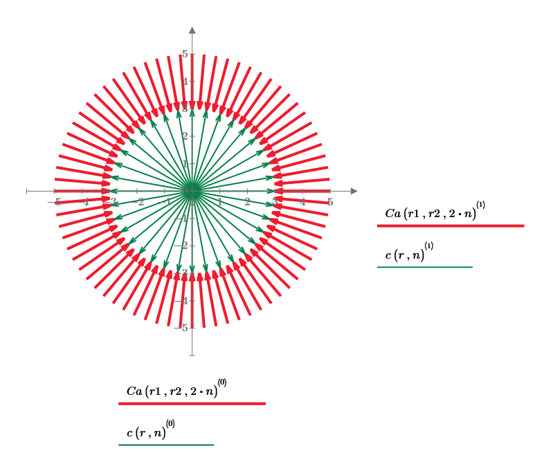

To show what could be done with a little ingenuity, attached is a file (courtesy of Luc and Werner, IIR) that draws grids and works in Express

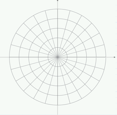

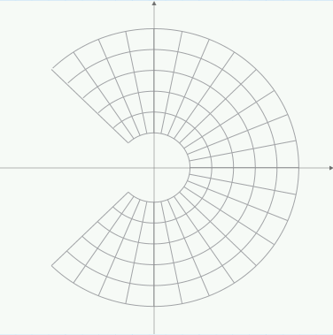

For a grid, I was thinking more like this:
With possible variations (Start and end of both radius and angle can be set) such as:
To quote a good friend, "Please post the worksheet!" 😊
