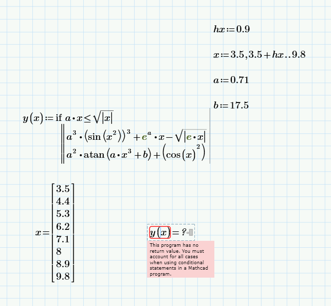

See how operators work - "Conditional Operators" from the "Help Center": https://support.ptc.com/help/mathcad/r10.0/en/index.html#page/PTC_Mathcad_Help/conditional_operators.html
you have to define else branch for if command. See below.

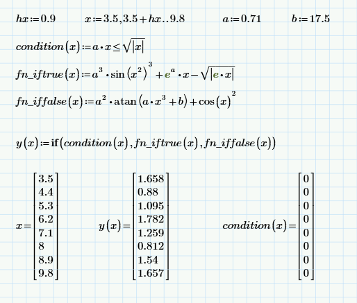

Here's an alternative approach (notice that, for the x-values you use, the condition is always false):
