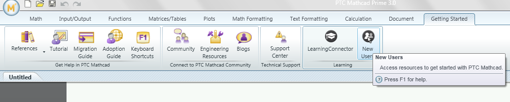

When I click on help (e.g New Users button) facility (e.g. http://www.ptc.com/http://communities.ptc.com/docs/doc-3621). The browser page opens, but I constantly get the message below. I very much appreciate if someone can advise how to fix this or else point me how to get help inside the application without popping up the browser (I have also tried different browser, encountering the same issue)

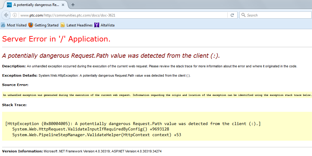

Server Error in '/' Application.
A potentially dangerous Request.Path value was detected from the client (:).
Description: An unhandled exception occurred during the execution of the current web request. Please review the stack trace for more information about the error and where it originated in the code.
Exception Details: System.Web.HttpException: A potentially dangerous Request.Path value was detected from the client (:).

Looks like you have 2 web addresses here, try:
I can't access the page as I'm not authorised, but the error message doesn't occur.
The address is missing an 's'; it should be https://

I am using PTC MathCad Prime version 3.0 datecode: 000 (2013.09.12.003/3.0.0.194). I have included the screen capture here for menu bar that when you click on things, most of them go to nowhere land i.e. ...Server Error in '/' Application.
I am just simply clicking inside the application. I should not worry about punching in the html address. The application should properly re-direct the browser (if needed) for help.  To Werner's point, I do not want to go browser each time I want to look up something.

Perhaps that meant the following:

This button:
Which does indeed give the error:
Because the URL is wrong (i.e a bug). As Andy notes, it should be http://communities.ptc.com/docs/doc-3621

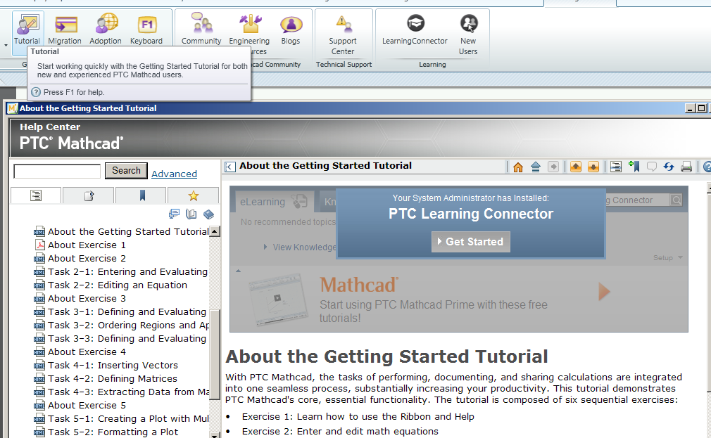

I also get the same error on Tutorial

And don't think that the address is hard coded in Prime but I guess that the real problem is the redirector at ptc.com.
The hard coded addresses in Prime 3.0 are
"New Users" -> http://www.ptc.com/product/mathcad/getting-started
"Engineering Resources" -> http://www.ptc.com/products/mathcad/resource-center
"Adoption Guide" -> http://www.ptc.com/product/mathcad/adoption-guide
Its unclear to me why Ramin wrote that the "Tutorial" button does not work for him, too, as this button opens a local help file (at least it does for me):

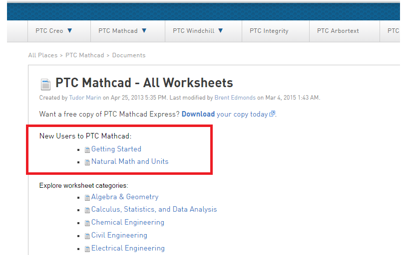

Ah! Now I see it. Its on the "Getting Started" .
I also have Prime 3.0 installed but I seldom use it (in fact I never really use it, just playing around out of curiosity) because its such a mediocre version not capable to replace Mathcad 15. At least not yet and some years from now I fear we have to live with that new UI and thats really negative prospects.
I can confirm that I experience the very same error as you had reported.
The link should be    PTC Mathcad - All Worksheets - PTC Community  ->  PTC Mathcad - All Worksheets
The reason Andy got his "not authorized" error when he tried to repair the link adress is, that "DOC" has to be written in capitals.

The same page should open when you press "Engineering Ressources".

When you press  "Adoption Guide" you get a similar error. It was meant that this document should open up
-> http://support.ptc.com/WCMS/files/154493/en/PTC_Mathcad_Prime_3.1_Migration_Adoption_Program.pdf
