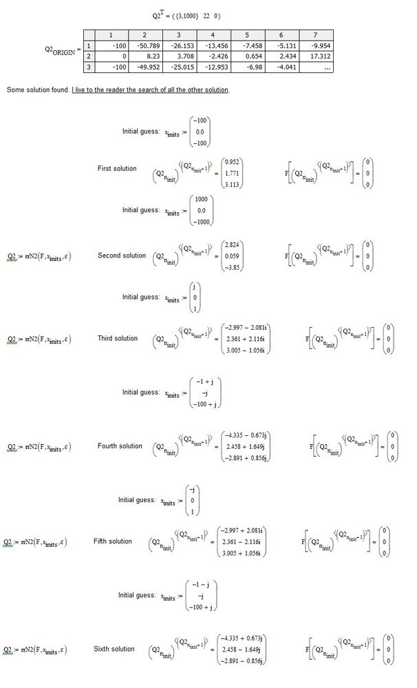

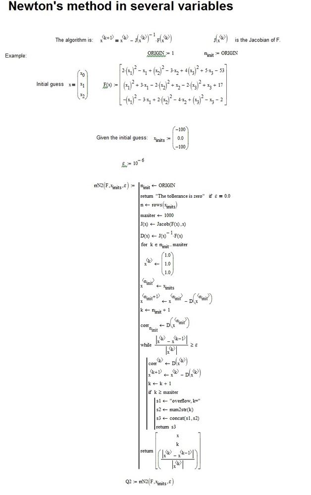

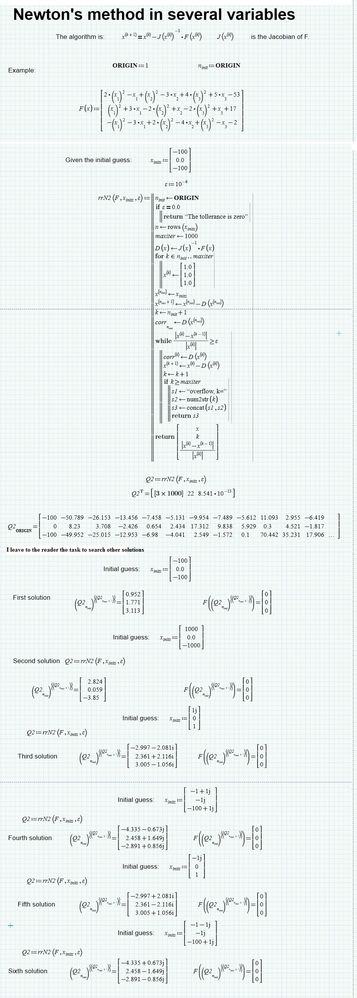

1) Newton in several variables.jpg2) Newton in several variables.jpgNewton in several variables Prime 3.1.jpg

I made some changes to your file to fit it to the  program . Each solution depends on the initial guesses that are very difficult to determine.
