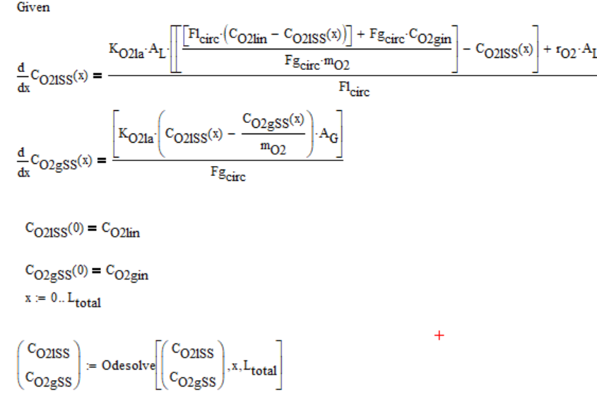

I'm new in Mathcad and I'm doing my thesis now. I have some trouble finding how to do iteration in Mathcad.
So in my file, I have a reactor of 250 m. And I want to know how the concentration changes.
But, I want the simulation to run for >1 cycle. Which means I have to define a way to make the Cout (concentration out) from previous cycle, as a value for the Cin(2) concentration in of the next cycle. These are for both liquid and gas concentration.
So in summary I want to make a loop of :
COlin (x+1) = COlout (x)
COgin (x+1) = COgout (x) + COgin (x)
Help guys 😞
Thank you in advance

Yes I did closed it with the Odesolver…
As you can see in my attached picture.

So you should have two functions of the two parameters.  What happens if you type C.O2lSS(2m), or try to plot C.02lSS(x) vs x?

Hey Werner & Fred, What i meant by iteration is a for loop.
I have a system with a fix inlet and outlet which has a length of 250 m.
1 cycle means that the system run from inlet into outlet for 1 time.
When i run the derivation, i use intial value of Clin (concentration liquid in) and Cgin (concentration gas in) which will give a result of Clout (concentration liquid out) and Cgout (concentration gas out).
For the 2nd cycle, i want to use Clout for the initial value instead of Clin. And for the gas, i will always want to use Cgin as intial value (fresh air).
Clin1cycle = Clin & Clin2cycle = Clout1cycle & Clin3cycle = Clout2cycle, etc.
Cgin1cycle = Cgin2cycle = Cgin2cycle = Cgin
However, i dont know how to translate in into for loop command in mathcad.
That's what i was trying to ask.

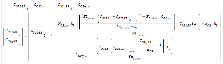

There's an old method in Mathcad that mimics Euler's approximation to ODE's.  This might work for you.
(set ORIGIN to 1)
