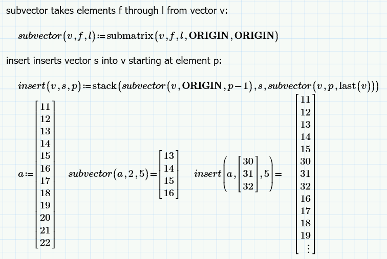

What you want (defining a function that takes a part of a vector) is possible, but Prime does not use colon notation. You can also insert a vector:
But NOTE: these functions work withy vectors only, not with range variables.

Luc already showed you how to use the "submatrix" command to achieve what you are probably looking for and he also told you that this command only works on vectors.
In your picture you wrote a:=11,12..20=.. and without knowing you converted the range into a vector by doing so 😉 The evaluation (=, display the result) immediately after the definition in the same region turns the range into a vector. Thats a very old, undocumented trick, so you may decide not to use it as it may not work in future versions of Prime (IMHO thats unlikely, though). So "a" is a vector now and you could use the "submatrix" command or Luc's function "subvector" to create a vector(!) consisting of the second up to the fifth element of "a".
Note further that by default vectors are numbered beginning with 0 for the first element. So the appropriate command would be submatrix(a,1,4,0,0). You can change that behaviour by setting the system variable ORIGIN to another value, maybe by typing ORIGIN:=1 at the top of your worksheet (its also possible to do that from within the menu). Now the numbering begins with 1 and the command would be submatrix(a,2,5,1,1).
If you want to be on the safe side regardless of the value of ORIGIN you could use submatrix(a,ORIGIN+1,ORIGIN+4,ORIGIN,ORIGIN).
