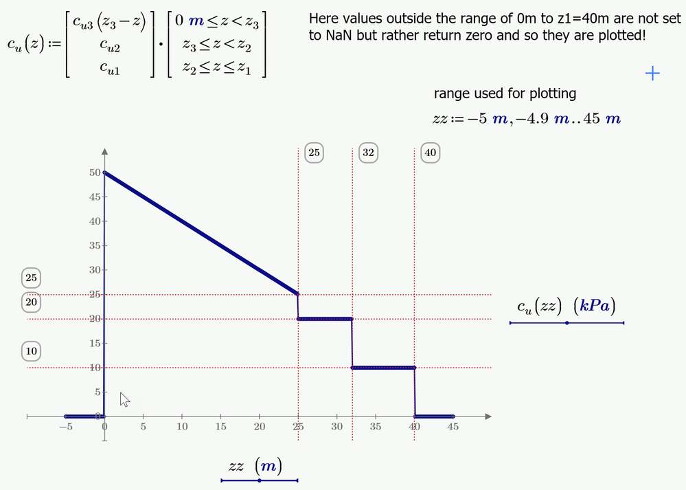

I have a set of values that varies along with elevation. I need help plotting the function but can't figure out how to proceed. I have described my issue in the attached file (prime 7).
Thank you very much for your support.

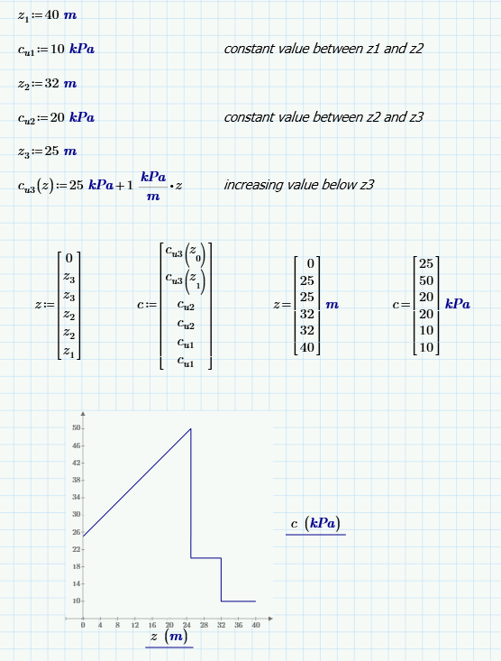

Here is what I understood so far from your descriptions:

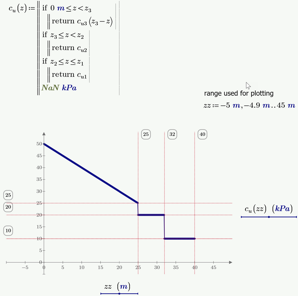

Of course the functions can be defined in various ways. You may use if and elseif as shown by ttokoro,
you may use nested if-functions similar to what you use in Excel (harder to read) or you may use multiplications with boolean expressions.
Sorry, attached file is Prime 10 format as I don't have P7 installed
But there is nothing hidden, the pictures show all that's necessary, your definitions are unchanged

Here's another option:
Alan

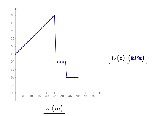

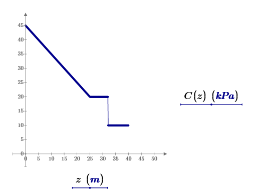

Thanks to both of you! I really appreciate it. Unfortunately, I made a mistake in the description. I want the value cu3 to increase by 1 kPa by every meter below the elevation of 25 m. Any suggestions on how to incorperate that into the function?
Thank you in advance.

Thanks to all of you for your help!
