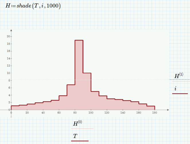

Hello, how I can shade area under graph in Mathcad Prime 3.1?

I didn't write this, I just fished it out of my collection and converted it to Prime
Neat.  For simple plots, you can also get by using the Column trace type (I've also selected the "Cross Axes at 0,0" to get rid of the space between the plot proper and the x axis).  I've doubled up on the target function to highlight the edge.

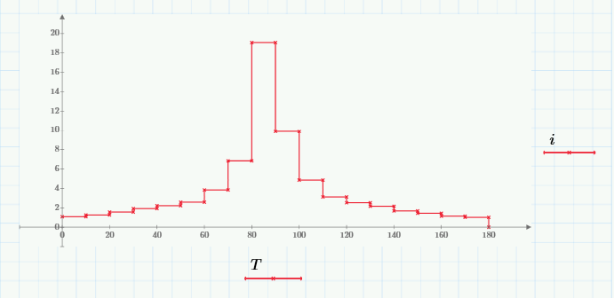

Hi Stuart, thank you very much for your help.
I want to make is this:
The red graph from data T i vs created. I want to color the green area.
I'm not sure that Prime will do what you want.  Where did you get that plot?   (And that colour green - it's not on my palette?).  I haven't looked at Werner's solution, but the nearest I could get using just basic settings was this:
But both our solutions need 2 traces, not the one that your plot shows.
Stuart

First approach could be to first plot the area underneath T-p in yellow over the full range as before.
Then you'll have to create a new vector of ordinate values, consisting of the values in i1 and surrounded by the appropriate values of p as the first and last values. Use then "shade" to color the area under that new vector in blue.
Or you write a routine similar to mine which shades the area of two graphs given by vectors. Then you would plot the area under p in blue first and the the area between p and i2 in yellow.
Writing that routine would even be more work, because to make it a real utility function you would also have to consider the situation, where the values in the abscissa vectors of both graphs don't match.
For shading the area under a function oder between two functions given by vectors can also use the routines which are presented or referred to here Shading Graph
as you can turn the vectors into a functions by using some sort of interpolation, e.g. linear interpolation. But unfortunately this will not work in your case, as "linterp" will not work on abscissa vectors containing equal values which you need because of the vertical line segments.
An option might be to write your own modified routine for linear interpolation.
Werner

Thank you very much for your help Werner, based on your file shade I could do.
The expected result is obtained with two functions and overlaying graphics shade:
SHADE 1
SHADE 2:
Here is the file for which interest them:
(To:rhanet)
Unfortunately my Prime 3.0 version can't read files in P3.1 format, so I am using a somewhat different vector.
I played around with my second idea and wrote a linterp2 function, which does not choke on equal abscissa values.
Using a short shade2 routine which shades the area between two graphs in a given interval I could also achieve what you wanted by turning the vectors into linear interpolated functions.
"fill1" could have been created using my original "shade", too.
Regards, Werner
