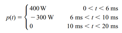

The result to be obtained

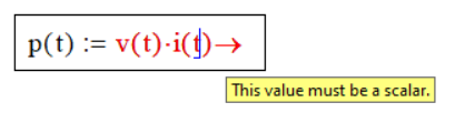

Can we somehow show the result of the power p (t) (i.e. the multiplication of v (t) with i (t)) in an analytically way, apart from the graphical solution?
Or, how can piecewise linear functions be multiplied analytically and the result can be shown, as above figure shown?

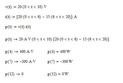

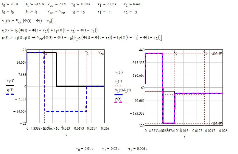

You could try this way (but note that symbolics don't recognise units):
Alan
