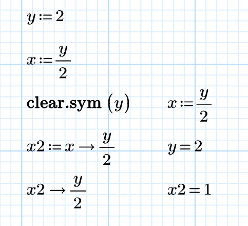

I'm tired of looking back at my work and seeing what did I set my variables equal to. I'm working on bending moment equations for the same beam at different load combinations. For load combo 2 I'd like to calculate the moment at the same spot as I did for load combo 1.. So x_lc2 ;= x_lc1 but I want to see the formula for x_lc1  like this x_lc2:=x_lc1=l/2. I'd like to see something similar to how excel would let you 'step in' to a formula. I know it feels kind of redundant but I just need that visual verification for everything I have to use this sheet for another project.

I don't have a clean sheet to post. To clarify I just restate the formula when I set it equal to a new variable. (see example below)
y:= 2
x:=y/2=1
V   (one eternity of pages later.......)
x2:=x=y/2
The bold is what I want to see in addition to just saying x2:=x. It's just so that I can quickly verify that x2 is based on the same formula as x without having to go search for x.

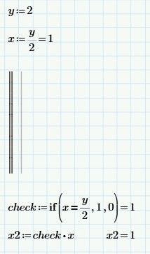

Here is one way to check. true is 1, false is 0 in Prime
