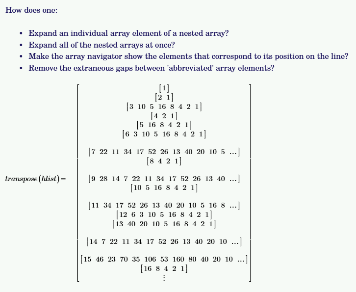

How does one expand nested array elements when viewing them?
StuartBruff
This has been a nuisance for some time, but ...
If I evaluate a nested array, the matrix navigator seems to have little effect, sometimes nested arrays won't resize, and there doesn't seem to be a way to resize all of the elements at once ... not a happy state of affairs for large arrays.

Expand the transpose(hlist) array.
• Expand an individual array element of a nested array is ok.
• Make the array navigator show the elements that correspond to its position on the line is ok.

How strange.  I just tried it and I could resize elements (although not all at once).   However, I then tried again on a different worksheet and the nested array wouldn't resize ...
For some reason, the recording software (Microsoft Xbox Game Bar) doesn't show the Matrix Navigator, although you can see where I'm using it.

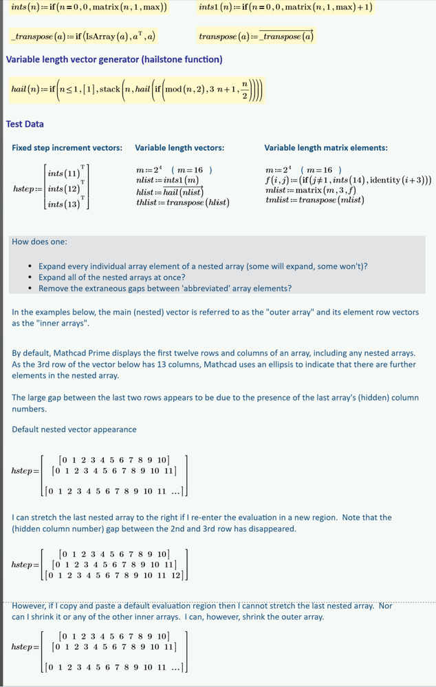

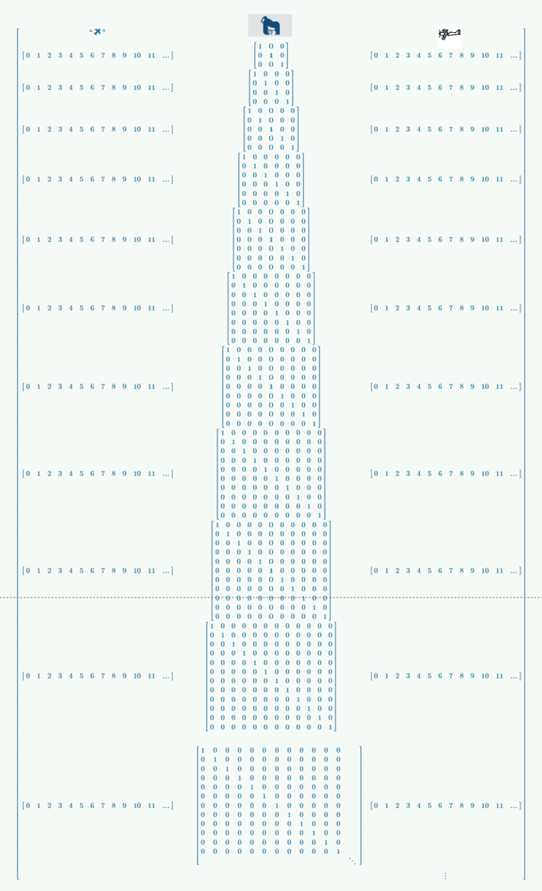

On to the star of the show, the updated Mathcad Prime 10 worksheet.
AFAICT, things are pretty much the same as in Mathcad Prime 7.
See worksheet for a few more examples of nested array manipulation.

What follows is one my usual streams of unconsciousness that flow like dried up brooks in a desert heatwave.  Having just evaluated the slightly more extreme case of nested matrices, my thoughts meandered off in other directions, cutting off the previous nested array sizing thread like an oxbow lake.

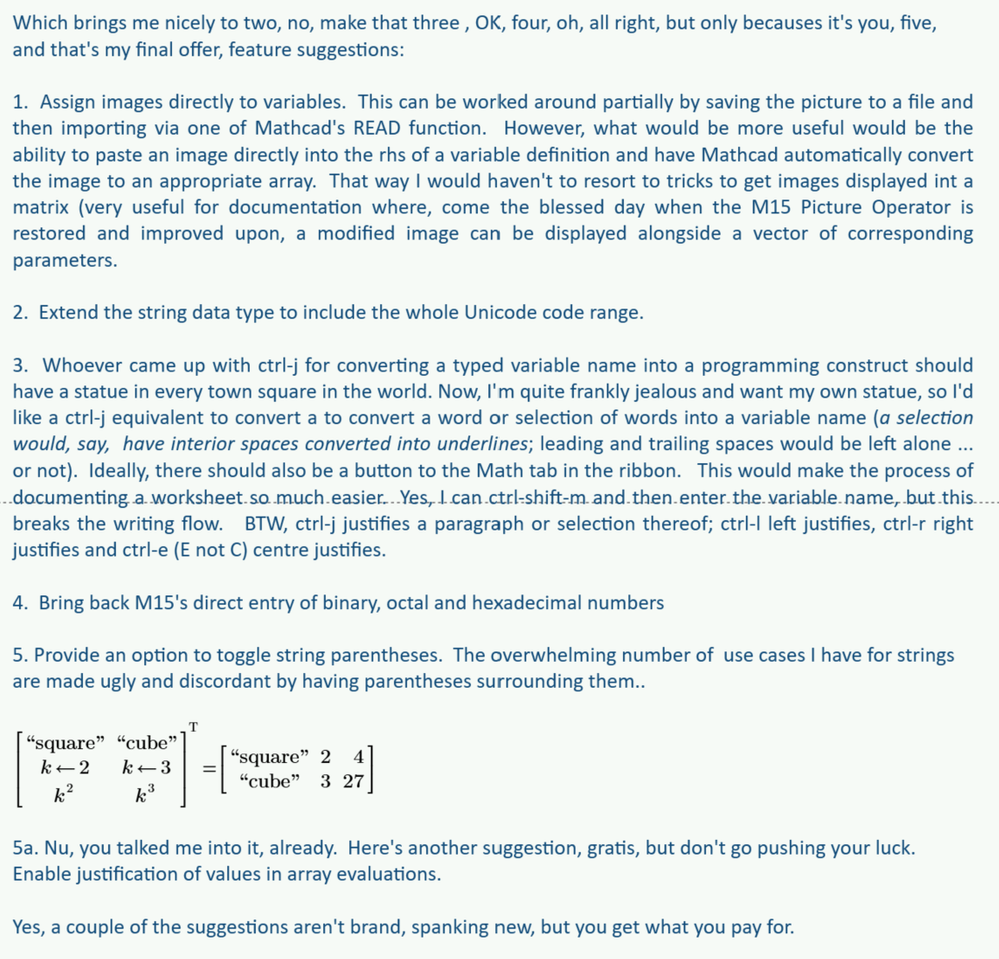

Apart from wishing for more nuanced matrix navigator and nested array size control, a few other ideas sprung to mind as I was constructing the amended worksheet.
The implicit feature request hidden in FR 1 is the ability to evaluate a Picture Operator in an array (and a text region!).
It would be quite neat if ctrl-shift-m carried out the FR 3 text to variable conversion, rather than replacing selected text with a math region as it does now.  The ability to toggle text-to-math conversion would be useful, as well.
Oh, and talking of Text Regions, tab stops would be a very welcome restoration of capability.
Stuart

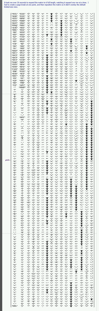

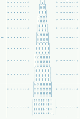

While modifying a Unicode worksheet I developed, I came across a reasonable case where the ability to expand a matrix fully would have saved a lot of time and effort.
Stuart
Note to self:  I really must get a portrait (orientable) monitor.  I wouldn't have had to set the zoom to 40%.
