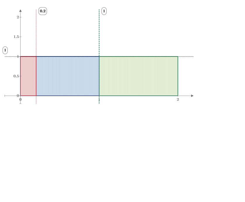

ttokoro
(To:KAL_1625)
Make Figure plot you want by Prime 8.

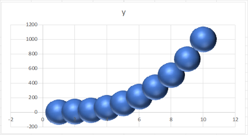

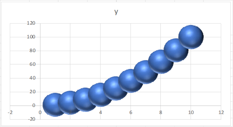

ttokoro
(To:ttokoro)
Not image but graph of EXCEL that selected by ComboBox of Prime 9 and show it Prime sheet by EXCEL compoment.
Now no need to use chart component if you can use EXCEL to plot the graph.
