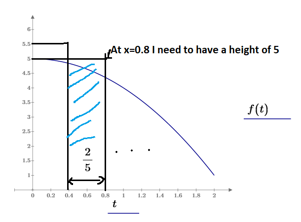

So, I need a function in which that if we give the Width and the Height of a rectangle, that function to draw the rectangle based on the Width and Height. Width to be a parameter that can be modified. Height to be a parameter that can be modified.
Cornel
(To:ttokoro)
@ttokoro
In the first case (inscribed rectangle):
Width is:
Height is:
In the second case (circumscribed rectangle):
Width is:
Height is:

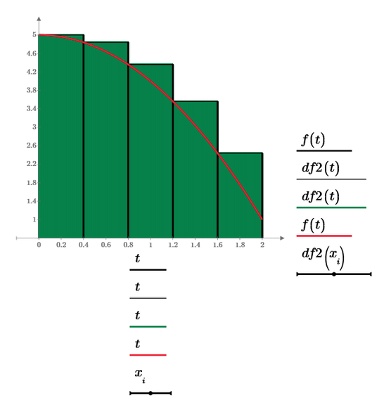

Can you tell me the options that you have selected in the Plot -> Change Type for this graph for each function: f(t), f(t). df(t), df(t), df(xi)?
Can you tell me the options that you have selected in the Plot -> Change Type for this graph for each function: f(t), df(t), df(t), f(t), df(xi)?
Or maybe if you can upload a Mathcad Prime 8 file then it is ok even this way.
Cornel
(To:Cornel)
@ttokoro
In Plot -> Change Type:
f(t) - Line Trace
df1(t) - Column Trace
df1(t) - Line Trace
df1(xi) - Column Trace
f(t) - Line Trace
df2(t) - Line Trace
df2(t) - Column Trace
df2(xi) - Column Trace
In your case, how you marked this options? How you did?
Cornel
(To:Cornel)
@ttokoro

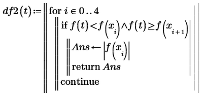

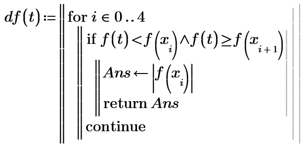

For the first case I found how to do:
f(t) - Column Trace
f(t) - Line Trace
df1(t) - Line Trace
For the second case, I still do not find the correct options:
What are In Plot -> Change Type:
f(t) - ............... Trace
df2(t) - ............... Trace
df2(xi) - ............... Trace
Cornel
(To:Cornel)
@ttokoro
So, it is ok now. I found now how to set-up each function in Plot -> Change Types also for the second plot:
f(t) - Line Trace
df2(t) - Line Trace
f(t) - Column Trace
