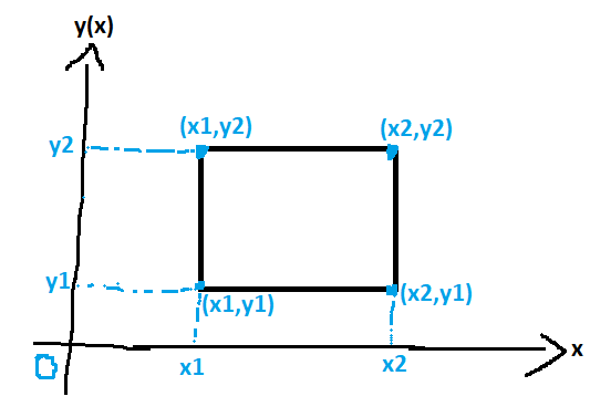

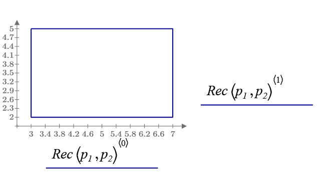

1. Given the below points: (x1,y1), (x1,y2), (x2,y1), (x2,y2), how to make a rectangle in Mathcad Prime based on this points?
2. Given the below points: (x1,y1), (x2,y1), (x3,y2), how to make a triangle in Mathcad Prime based on this points?
LucMeekes
(To:Cornel)

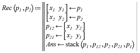

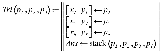

You can do both with this simple function:
where pl is a nx2 matrix of (x,y) points. Examples:
6 REPLIES 6
LucMeekes
(To:Cornel)

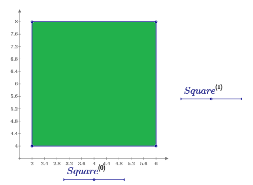

Cornel
(To:LucMeekes)

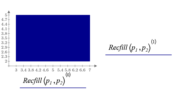

Is it possible also to put some colour inside the square/rectangle?
LucMeekes
(To:Cornel)
Sure, refer to the other thread on colour filling.

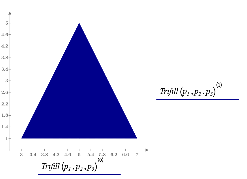

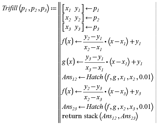

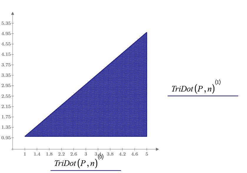

ttokoro
(To:Cornel)
ttokoro
(To:ttokoro)
This is only p1=[3,1],p2=[5,7],p3=[7,1] type.
ttokoro
(To:Cornel)
