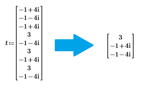

I have this vector:
I want automatically to eliminate duplicate elements, and to retain only those elements which are not duplicate from the vector:
How to do this?

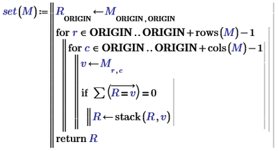

Here's one method:
example:
11 REPLIES 11
LucMeekes
(To:Cornel)
Here's one method:
example:
Cornel
(To:LucMeekes)
Thank you.

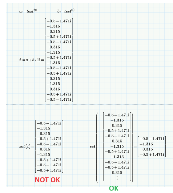

Why in the second case function does not work properly? Why I need to give separately entire vector, and not t variable? In the first case it worked...
LucMeekes
(To:Cornel)

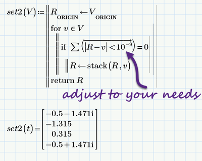

Probably the cause is numerical (in)accuracy. Your numbers have 17 significant digits at most. The set() function requires exact equality.
Cornel
(To:LucMeekes)
Ah, ok

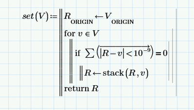

(To:Cornel)
Cornel
(To:Werner_E)
@LucMeekes
OK
Not OK

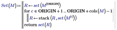

Is it possible to modify the above set() function in order to accept also a matrix?
LucMeekes
(To:Cornel)
Do you want them by column:
or over the entire matrix:
Which can also be:
Cornel
(To:LucMeekes)
