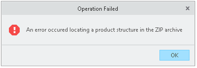

We are trying to create viewables from our MathCAD files and to save them to Windchill, where other users (who don't have MathCAD installed) can check the files and optionally comment on them.
From the documentation we can find that it should work as follows:
  • Create MathCAD and checkin to Windchill
  • Client side viewable is automatically created (Mathcad Checkin) by setting "Models and Viewables" in wgmclient.ini
However, the viewable is saved as Viewable.PVZ and included as attachment to the MathCAD sheet. Attachment can only be downloaded and not opened.
Also the PVZ file can not be opened using Creo View and thus not be annotated and saved back to Windchill.
Below the error message when opening the downloaded PVZ. This is because the PVZ only holds a pdf and no structure.
Is there a configuration step that we're missing or does it work as designed? Is there a way to save the viewable as PVS (which can be opened by Creo View)

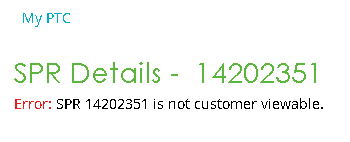

Hi Vladimir,
Thanks for the article re SPR tracker, however when trying to open the previously linked SPR I get the following:
So that does not seem to work in this case. Would this SPR only be visible to the initial customer who had this issue?
kind regards,
Alexander Boogaard
Yes, it can be. But you can create a new Case for your problem: https://support.ptc.com/apps/cs_loggers/case_logger/auth/ssl/log
