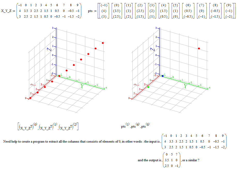

   Hello Everyone,
From :
  How to extract many columns that consists of elements of 0 ?
  Many thanks for your time and help in advance.
    Best Regards.
        Loi Le.

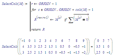

Something like this?

  Many thanks again, Luc. I greatly appreciate your time and help.

The attached file should help
EDIT: Alas, Luc has beaten me in speed and elegance!
