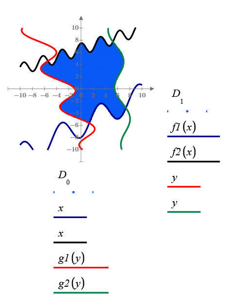

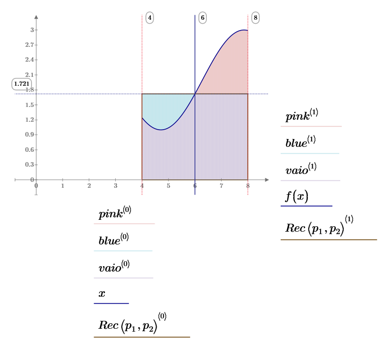

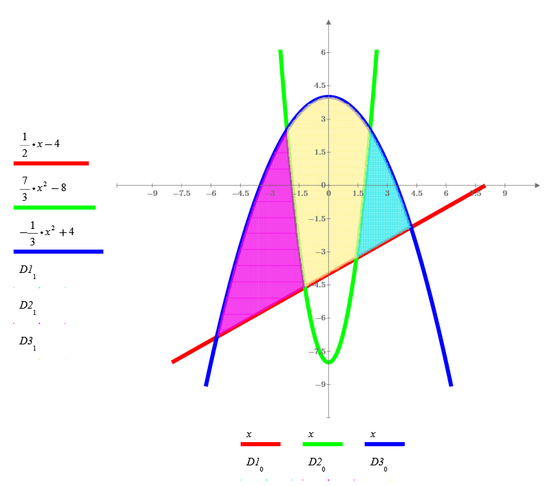

Is it possible to fill the area under the graph with some colours like in this example from below?
So, from
with some colour
and from
with other colour
Mathcad Prime 8 file attached.

A boolean function which determines if a point is inside the region or not can fill simple dots. Werner shows the plot by Mathcad 15. I try to use Prof. Birkeland's work posted by Werner for plot it by Prime 9. I need some time and now I can ues the Dots function to fill the area by Prime 9. Thanks all infomations.

There is nothing hidden - at least not in the picture (MC15) which I posted here and in the other thread.
 Its the very same in Prime with no modification necessary!
Grab the small very first function Dots() in the already posted sheet of Prof. Birkeland (you don't need anything alse for a simple dotted fill)  and then do what is seem in my screenshot. Format the dots to use a dot as symbol and no lines.
You may have to experiment with the number and sizes of the dots because Prime only allows to set a very (too) limited number of sizes.
The example(s) shown by ttokoro stem from here -> Solved: Re: How to fill a quadrilateral with color ? - PTC Community

Werner_E shows the Mathcad 15 file and we can convert it to Prime 8 or 9 file.
All Prof. Birkeland's functions are able to  re-calculate and plot in Prime 9.
So, we use the boolean functions that Werner_E show us in the SNS.
Just try it.
I attach Prime 9 format here.

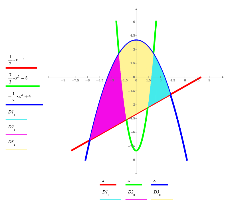

Is it possible to color it like this?
(To:Cornel)
Sure! Why shouldn't it? Have you ever gave it a try???
Simply use
for the boolean functions.

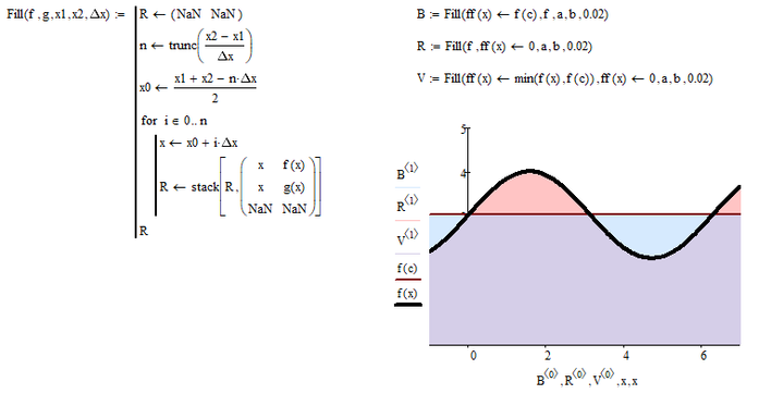

The boolean functions are needed to use the various fill and hatch functions from Prof. Birkelands sheet which I already posted and also mentioned now an then. Its a very versatile concept and there is no need to "invent" a new "trick" for every new situation.
The boolean functions describe/define the area to be filled (with dots, with parallel lines, with a family of curves,...).
(To:Werner_E)

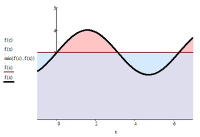

And, yes, ... you can achieve a similar effect using just stem plots if you take care of the order in which they are plotted and if  you think about the "trick" with the min() function.
I definitely won't suggest doing so!
(To:Werner_E)
And of course you may also use the simple fill/hatch function which was already posted in various variants here.
Again you have to take care of the order in which the traces are plotted and again you need apply a little trick like the min function.
So I sure would prefer the Dots() function or the like as being straightforward and most versatile.
