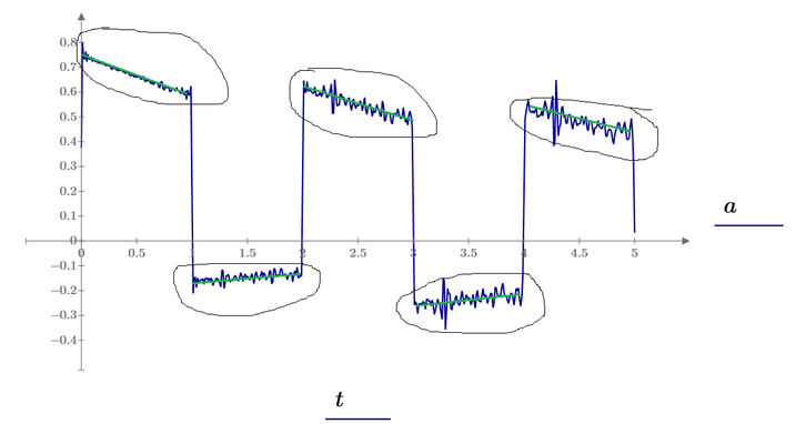

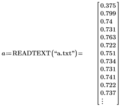

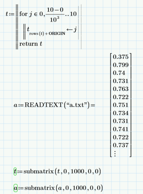

I have this signal formed by a vector data points:
And I want to make the  blue signal (a) to look like more green signal interposed on the blue signal:
Is it possible to do something like that from the a vector data points?
Idea is that I want to have straight lines also on this portions of waveform:
(To:Cornel)

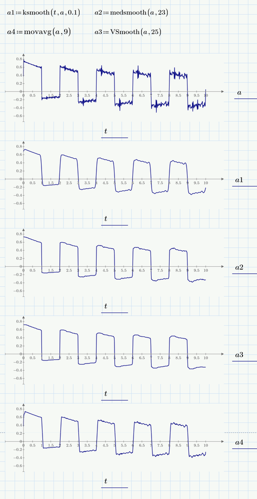

You may try the built-in data smoothing functions , play around with their parameters and see if the results fits your needs.

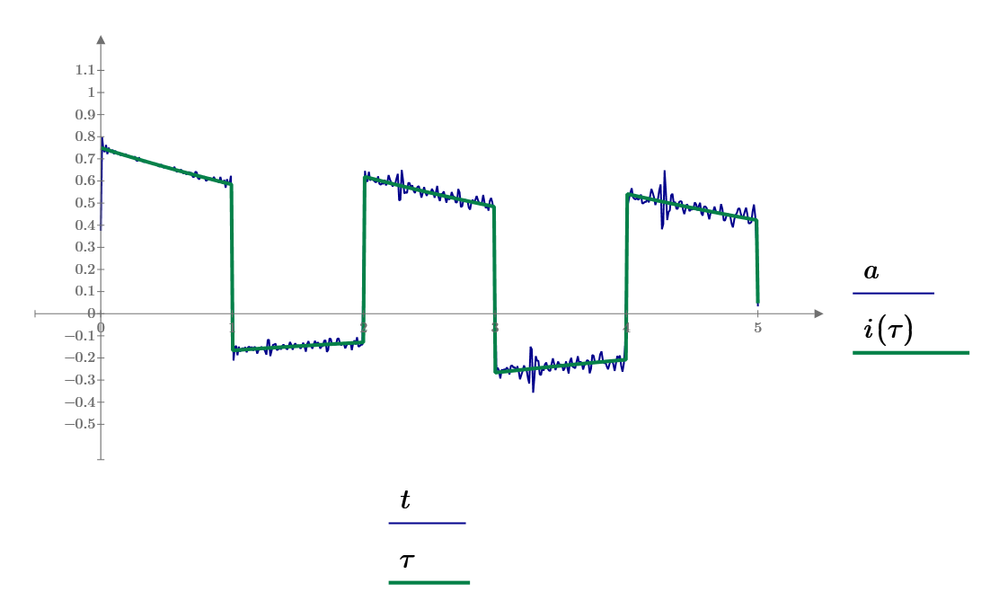

Here's another possibility (where the averaging is somewhat arbitrary!):

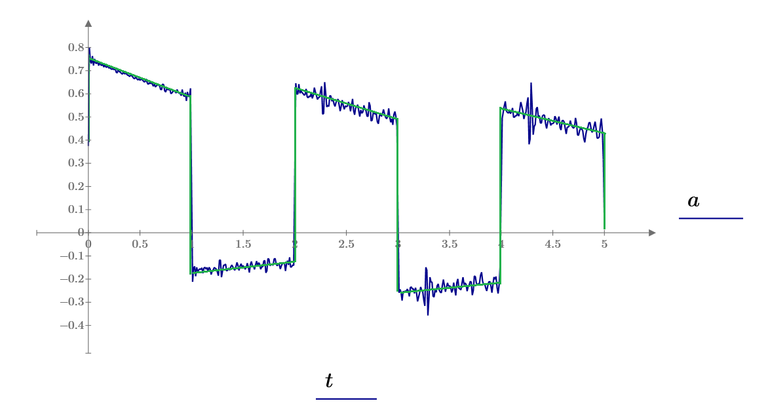

C=4 is fixed by hand. Using minerr for solveblock is more smart way to solve C.
