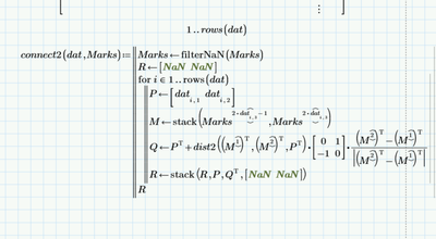

Concerning your new question I don't think that i can help. The function "connect2" you reference is a function which creates the data structure necessary to plot the line segments from every green point to the red LINE nearest to it - that way visually showing hat minimal distance.
The function is called "connect2" because it followed "connect", which would do similar but by connecting each green point and the nearest red point.

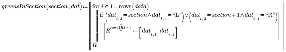

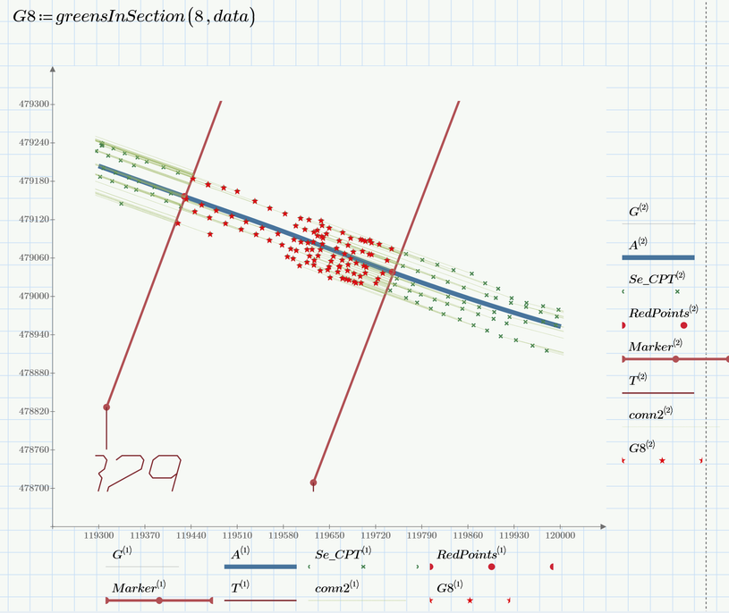

In case you just want to create a list of all green points within a certain section, we could add the information, if the point is left or right of the red marker line
and use this information to select all points within a section
Example:
In the attached P10 file I got rid of all regions not relevant to the question. If you can reduce the sheet further, please do so before you re-up it again. Smaller sheets make life a lot easier!

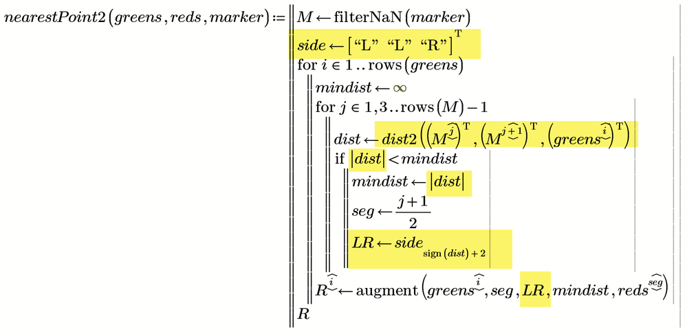

Hi Werner,

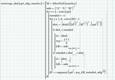

Actually I tried to write this program depending on your previous solution>> to find the distance between markers and the previous green points

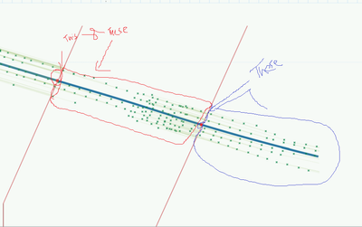

when I say before I mean example : distance between  marker 2 all greens(cpt) (which located in between marker 1 and marker 2 )
dist3 will be ( marker3 and all greens located in marker 2 and 3)
Do you think what I wrote is correct? >>> I'm asking because I honestly don't know why I used (seg) I just follow your steps

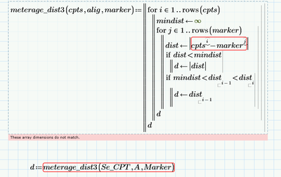

also tried this one:

Note that in the approach above I simply added the information in the data structure created by "nearestPoint2" if a point is to the left or to the right of its closest marker.
So if a point is between marker 2 and marker 3 it can be closest to marker 2 but because its left/right column says "L" I know that its between marker 2 and 3 and not between marker 1 and 2, But the distance in the mindist column still will be the distance to its closest marker which is marker 2 and the segment marker in the "seg" column still will say 2.  If you rather need the distance to marker 3 (the next marker, not the closest one)  in this case, the function "nearestPoint2" would have to be modified accordingly.

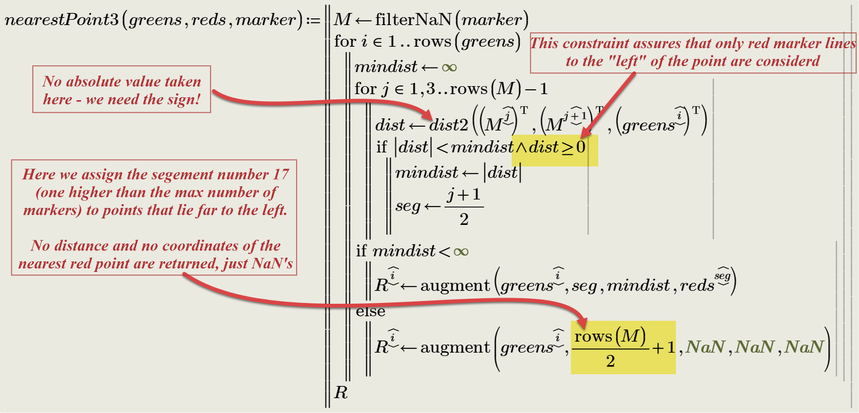

The NaN's are returned if there is no "next" red marker line. This is the case for the points a the left of the road.
Maybe the first in that series on NaN's ("seg" column) would better be replaced by the maximum marker number +1. This would make selecting them later easier.

@YA_10963798 wrote:
So , the last one you sent will get  the distance between all the greens in region ( between marker 2 and marker 3) to marker 3  only regardless the nearest marker >> if so, this is exactly what I'm looking for.
One more question >> how do you know that mathcad is not also calculating the distance before marker 2.. what is the expression?
thanks in advance
The function dist2 returns an oriented distance, this means that the sign indicates on which side of the line the point lies.
In my first version I just used the absolute value of dist2 because we were looking for the nearest red line, regardless if it is to the left or to the right of the point. In the new version, only values with a certain sign are considered.

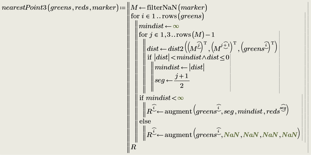

There was an error in the function I posted before as it should read dist>=0 and not dist<=0 if we only want to consider red lines to the left of the green point.
That way the numbering of the segments  now start with 1 (and not with 0 as before) and end with 17.
Segment 17 indicating points to the left of the last 16th marker - of course no distance is returned but rather a NaN for these points.
The slider to select the points in a certain segment at the end of the sheet was also modified. Formerly it ran from 0 to 16 whereas now it runs from 1 to 17.
Segment 9 now means the segment between marker #8 and marker #9.
Segment 1 are all points to the right of marker #1 and segment 17 all points to the left of marker #16.
Attention: I did not use input values and scripting when implementing the slider. It was a quick hack and the values 1 to 17 are just "hard coded" by editing the Properties of this component. If necessary it would be possible to make the limits (especially the upper one) dynamically changing according to the number of markers provided.
