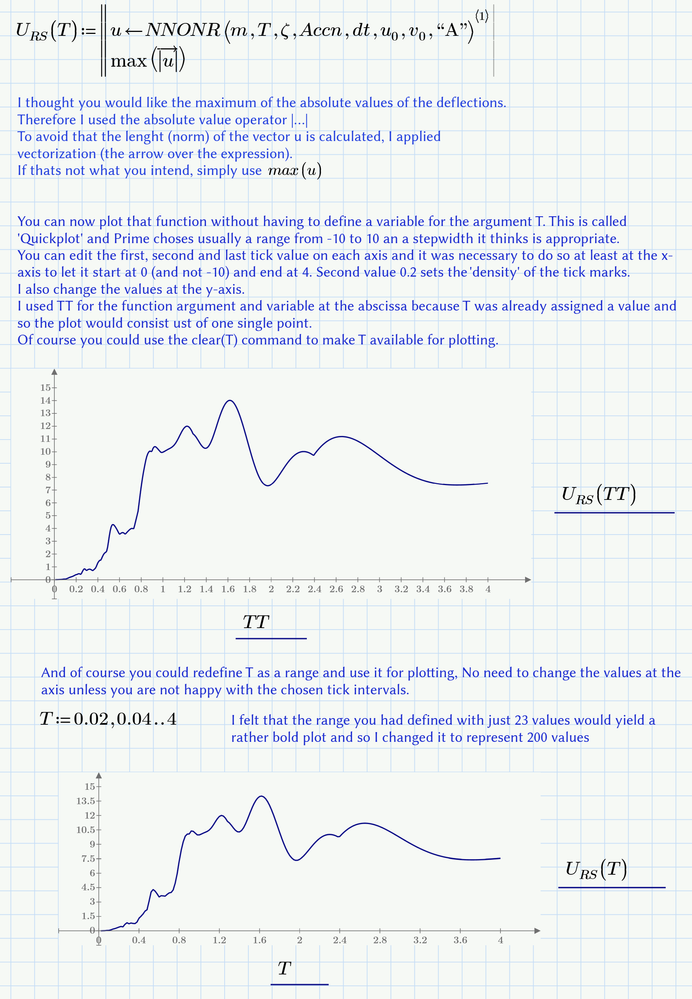

Here are my 2 cents. A simple function should do the job.
Prime 9 file attached

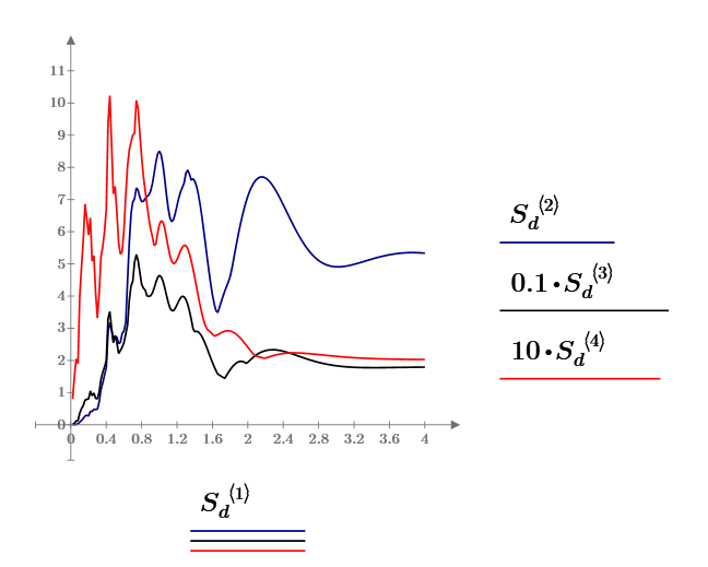

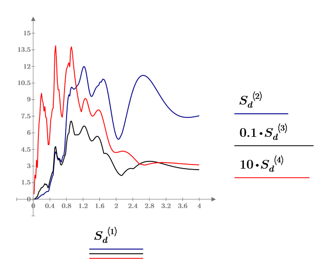

I have been using Mathcad to apply the Newmark method and successfully plotted the displacement versus time for earthquake ground motion. However, I'm facing a challenge in extracting the maximum displacement values for each time period (T=0.02s to 4s in increments of 0.02s) from my plot.
 My goal is to create a new plot with time on the X-axis and the corresponding maximum displacement values on the Y-axis (Response Spectrum Curve)
I've attached the Mathcad file for reference. I would greatly appreciate your insights.
Thank you very much for the help. I really appreciate it.
