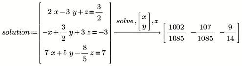

How to get the result as a column instead of a row?
OO_14410365
2-Explorer
22 REPLIES 22
Unfortunately, I only have Express, so I can't help with the presentation of the symbolic result.
Perhaps, try putting the variables in a vector?
            [x_1]
solve, |y_1|
            [z_1]

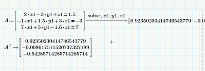

You can assign the result to a variable and transpose it.
However, is there any particular reason you want to use the symbolic processor to solve the equation, when a numeric solution seems to give reasonable results?
Stuart

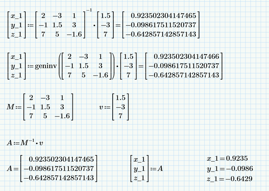

Stuart's got it: simply assign result to a vector and then take transpose.  P11 file attached.
(To:OO_14410365)
The symbolic solve will always provide the solutions row-wise and there is no option to set which will change this behaviour. You will get further rows for non-linear systems and each row represents a solution set.
I also think that in case you are just looking for the numeric values its better to use a numeric method and not the symbolics. Stuart has already shown some ways. Other options are the usage of the "lsolve" function

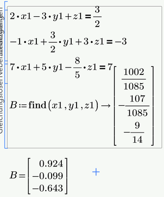

or using a solve block with "find" (you have to provide arbitrary guess values) which displays its results column-wise as you like it.

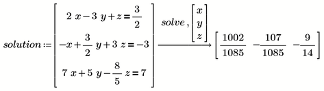

You may also assign the result of the symbolic "solve" a row vector (1 x 3 matrix) with three variables which you then can evaluate symbolically or numerically and use for further calculations.
EDIT: If you really want to use the symbolic engine and insist on a column vector right from the start, there is a way to do it: You have to use a solve block with "find" which is evaluated symbolically:

Yes, the symbolics accepts the list of variables as I did, but also a vector. It does not matter if its a column or a row vector.
It also accepts a mixture

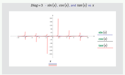

Hey, I know it might seem like taking imagination to Verrücktheit levels, but don't knock it.
One look at that, and a Company Board couldn't fail to get behind an engineer's request for such an upgrade, and throw their financial might behind their appeals to the Mathcad Prime 13 Requirements Team (and, perhaps, allow an enterprising engineer the opportunity to slip in a few minor requests alongside it (such as empty arrays or lists)).

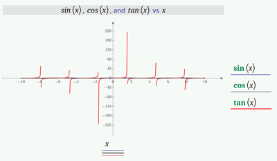

A more worthwhile enhancement priority, in my parochial view, would be the ability to insert a Plot region into a Text Box, in the same way that we can insert Math Regions into Text Boxes.
At the moment, all one can do is paste an image of a plot into a Text Box - having suitably sized it in an external application, such as Paint (not a very satisfactory state of affairs).
The above representation of an embedded plot also shows the utility of being able to hide the define operator ("=").  The diagram number (which should have an intrinsic Mathcad autonumber) would look far better without the equals sign.

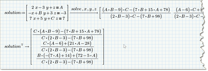

lsolve is easily implemented in Express (for many, if not most, but certainly not all circumstances) with:
yielding:
