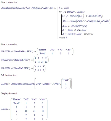

I am trying to read several .dat files from a certain folder by specifying the path in Mathcad 15.
I wonder if there is any script function to do that instead of inserting all the files one by one?

Something like this:

If your files are sequential in their name - "data_1.dat", "data_2.dat", etc., you can write a program loop that will read the data from each file and place them all in a matrix. This approach worked very well for me.
Hope this helps!

Hi @ChrisKaswer. Thank you for your reply. Do you have a template to share?
Yes - what Luc has shared is very similar to what I have implemented. You can get a bit more complicated by monitoring the size of any data file and reading files that have different row and column counts. Units can be read-in as well with some other tricks (of course the data needs to be set-up to accommodate this), but Luc has captured the fundamental approach well.
Good luck!

Thank you @LucMeekes for sharing that. That is very useful.

Is there a way that we give the path and the file ext, and then Mathcad returns all the files having that ext?

You mean like this:
Sorry, only in Mathcad 11, not in Mathcad 15.
