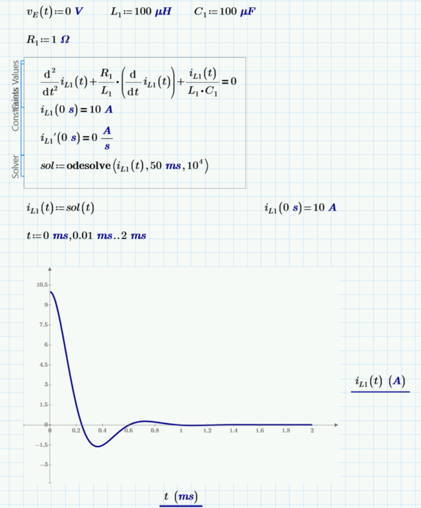

How to parameterize odesolve with some paramteres?
Cornel
Right now is as below.
I want to have something like this: is it possible?

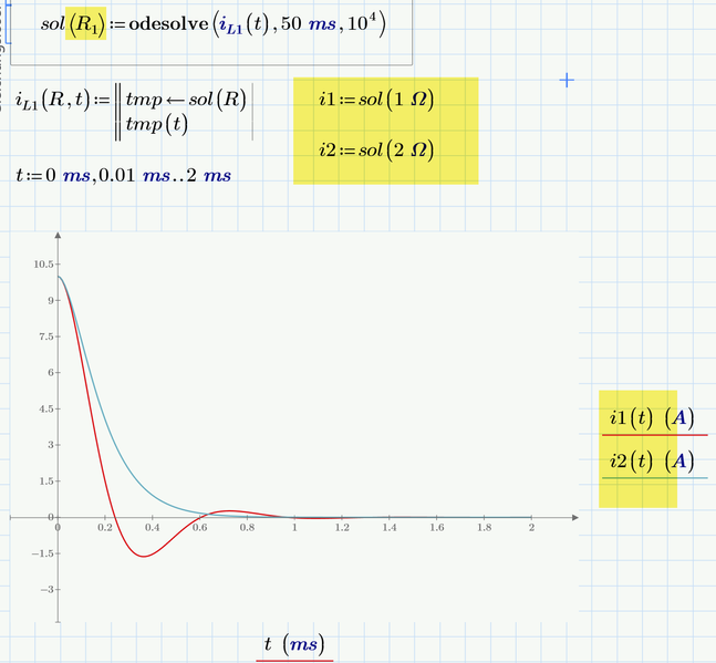

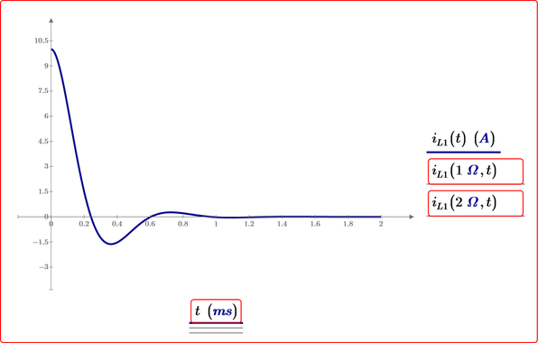

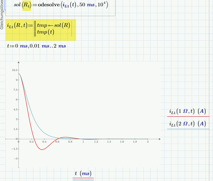

(To:Cornel)
Note that this method is very inefficient, because the solve block is evaluated from anew for every value of t.
More efficient but maybe less convenient is this:
1 REPLY 1
(To:Cornel)
