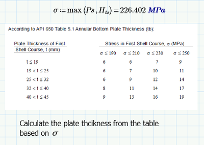

How to prepare the equation mention below
ranto
11-Garnet
3 REPLIES 3
LucMeekes
(To:ranto)
Try this:
Example:
Prime 3.1 file attached.
luc

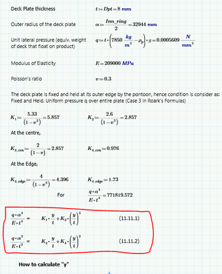

ranto
11-Garnet
(To:LucMeekes)
I had learned new thinks today
ranto
11-Garnet
(To:ranto)
 How to to calculate "y" in the below mentioned equation.
