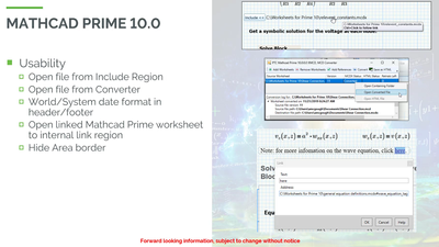

Could be as soon as March / April 2024, if our forward-looking information holds true.

Prime 10 now offers the feature you request - hiding the line.
