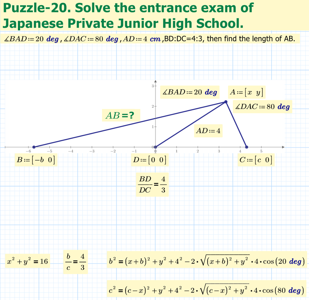

This is a quiz for age 12. How to solve this by using Mathcad?

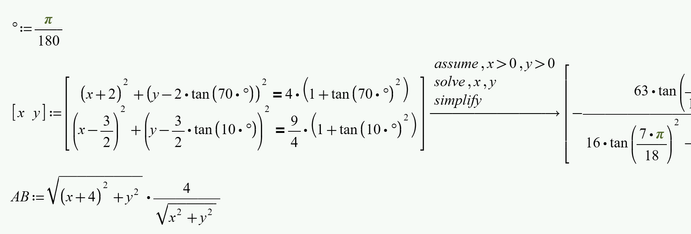

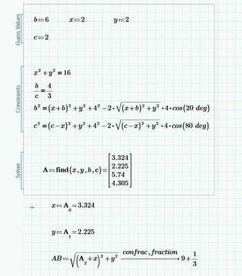

(To:ttokoro)

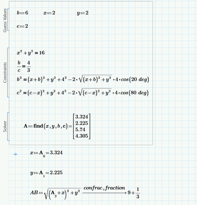

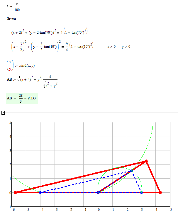

You have already set up four equations with four unknowns. So you could use a numeric solve block (add constraints like x>0, y>0, b>0,  c>0) or the symbolic solve.
Maybe you did in the sheet but I can't open it with P6 using the usual trick of exchanging the app.xml - maybe you used some new features not available in P6.

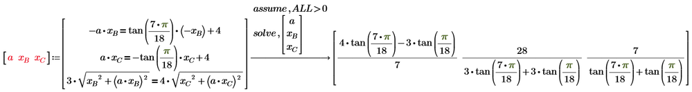

Here is a different approach (of course done in real Mathcad 🙂 )
Worksheet attached.
LucMeekes
(To:Werner_E)
Attached TTokoro's file for Prime 6.
(To:LucMeekes)
Thanks.
So I see he did not attempt a solution but just provided the four equation. In his collapsed area he used the solution 28/3 to calculate the points for the plot.
Prime cannot solve his system symbolically. Both engines throw a "no solution found".
I haven't tried but a numeric solve block should do the job but we won't be able to arrive at the exact solution 28/3 that way.
My approach simply followed the idea "how would I draw that figure with pencil, ruler and compass".
But being an entrance exam for Junior High I suppose there must be a much easier approach to solve the task.

(To:ppal)
Yeah, as I suspected a numeric solve block does the job. I was too lazy to try as it was clear that unfortunately this would not give us the exact solution 28/3.

(To:ppal)
Nice!

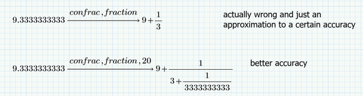

But while we know that this fraction really is the correct exact solution, we can't be sure about it if we only use a solve block which relies on numerical (approximation) algorithms. The solve block yield 9.3333333... up to the IEEE precision of about 14-17 decimals and the symbolic confrac,fraction actually delivers a wrong result (because the input value consist of only a finite number of 3's).
Actually what we see is this:
An exact result would be
So the point is that it could be possible that the true exact result is so close to 28/3 that the symbolic "confrac,fraction" with standard precision returns 9+1/3 but actually the true result could be slightly off. It actually isn't but as soon as we use just one numeric only algorithm in the chain of calculations we cannot know for sure.

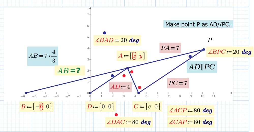

This is the answer for 12 years children. Prime 8 only solve this puzzle numerically even using Werner_E's method.
This shows only both side of = sign is almost same.

My solution is a pure symbolic one and so far exact and not a numerical approximation! I think it should be possible to do it in Prime, too. As Prime does not allow to symbolically evaluate solve blocks, you would have to use  the symbolic "solve" with the modifier "assume" for the constraints (x>0,y>0). I am not sure it the new symbolic engine is capable enough, though.
BTW, it was just in the last step that I had to help Mathcads symbolic a little bit to get rid of sine and cosine to arrive at the simple solution:

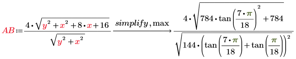

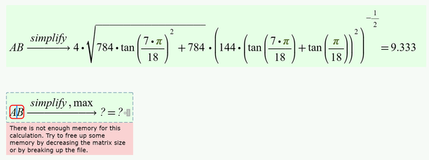

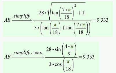

OK, I gave my approach a try in Prime.
Symbolic solving worked OK
But when it came to simplifying the expression for AB, the new symbolic once again failed.
Here the results with the old symbolic engine (muPad):
As already written above, in the last expression its necessary to tell muPad that the sine and cosine are equal because the angles add up to pi/2.
Here what the new symbolic does (after a very long time of "thinking"):
The modifier "max" uses up all memory and then fails without returning any result 😞
I can't check but the "result" may be the same in Prime 8 as well. Don't think the symbolic engine really has significantly improved.
So once again it proves that in current versions of Prime its better to avoid symbolic calculations - they seem to are not worth the effort and hassle to find suitable workarounds.

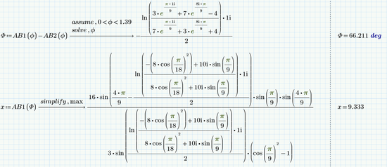

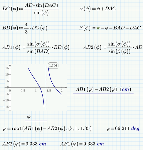

How about this one?
I thought this was going to be simple!
I appear to be missing a constraint.  Prime 4 Express attached.
An error lies here
Either write AD instead of AB or exchange sin(alpha) for sin(beta).
One additional constraint you are looking for could be a second way to calculate AB
BTW, the value for AB is not 9.333 but exactly 28/3 which of course can't be proofed by using numerical algorithms like "root".
But symbolic calculations fails, too, to proof the result is 28/3.
The new symbolic switches to float mode and so the result is unusable for a proof:
The old symbolic succeeds in an exact solution for phi but fails to simplify AB down to be 28/3:
I really like the solution sketched by ttokoro using just some ratios and avoiding trigonometry completely, but I still wonder which 12 year old would be able to come up with that kind of solution to pass the entrance test. I guess I myself  would have failed ...
(To:Werner_E)

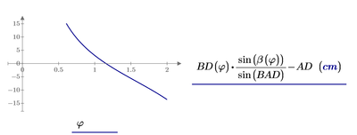

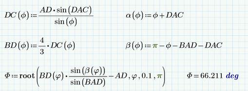

Here another suggestion for an additional constraint to get the value of phi. We calculate the length of AD using BD, beta and BAD and check, if its equal to predefined value AD=4
Here the choice of the range for phi is less critical so we get a good result even by using the large range from 0.1 to pi

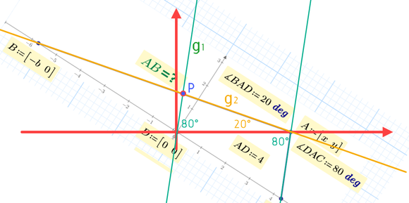

(To:ttokoro)

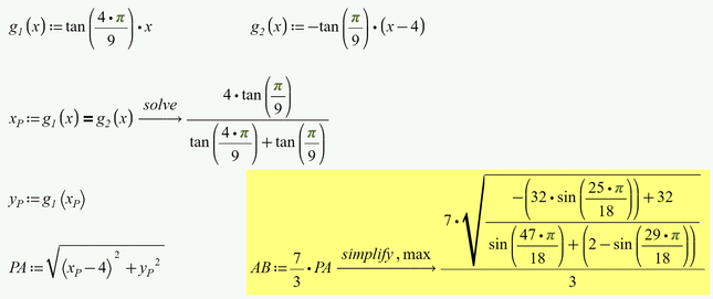

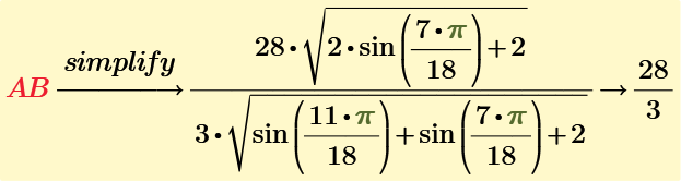

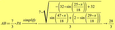

OK, I thought of a second way to draw the figure using pencil and ruler and now the calculation is much simpler.
I use a different coordinate system with D(0/0) and A(4/0).
The parallel g1 to AB through D and the line AB intersect in P and because of BP:PA=PD:DA=4:3 we have AB=7/3*PA.
So the whole calculation simplifies to
I haven't tried but I guess that even Primes new symbolic engine should now be able to arrive at the exact solution.
Remark: Of course in the picture we see at a glance that in the triangle DAP the angle at P is 80° as well (all three angles must add up to 180°) and so we have an isosceles triangle with PA=DA=4. So we can tell without further calculation that BA=7/3*PA=7/3*4=28/3.
This is similar to what @ttokoro already had shown as the solution for (or from) the 12 year olds 😉

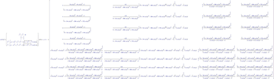

OK, now I gave it a try and it seems that I was wrong. The new symbolic engine can not even simplify this expression - at least not in Prime 6 (the legacy engine of course succeeds).
The new engine is now calculating for quite some minutes and I don't have the patience to wait for this calculation to perhaps end at some point. Possibly again without result and with the "out of memory" error message ...
I attach the Prime sheet if anybody likes to give it a try himself.
EDIT: Of course I was curious and let Prime work in the background. Here's the result: 😞
Without the modifier "max" we get the very same result, but much faster.
EDIT 2
Incredible! A second symbolic evaluation does the job! Why, oh why, doesn't the engine get it right on the first run???

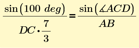

ttokoro

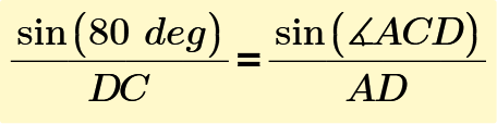

(To:ttokoro)

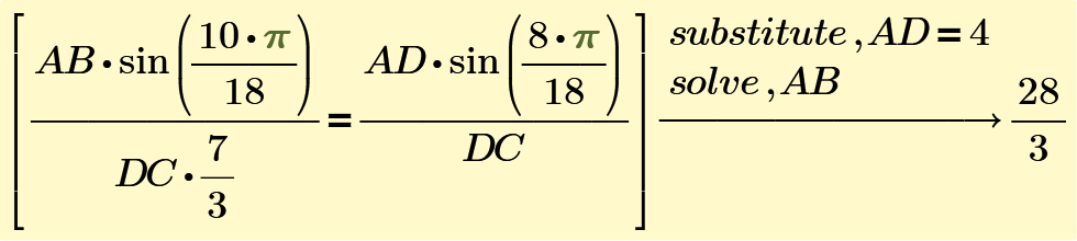

Using the law of sines in the triangles,
Therefore,

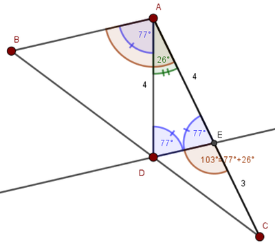

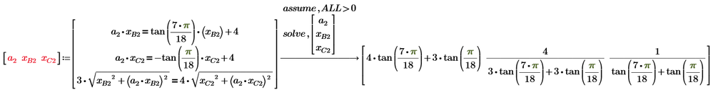

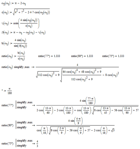

(To:ttokoro)
4:3 w/o calculation.
Actually thats nothing significantly new compared with #20 because 2*77°+26°=180° similar to  2*80°+20°=180° in #20.
So AB // DE ...
Looking forward for an exact, symbolic solution in Mathcad or Prime 😉

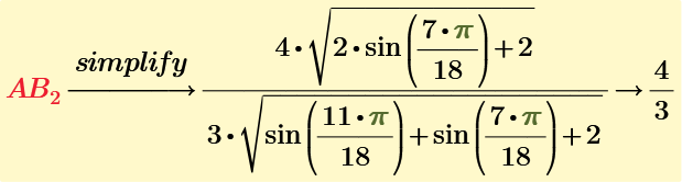

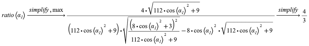

(To:Werner_E)
The symbolic engine seems not to be capable enough.
Of course the result is always 4:3 independent of the input value alpha.1
The symbolics only succeed for 75° / 30° instead of 77° / 26°
ttokoro
(To:Werner_E)
Prime 8
The last 3 equations only can that and can't simplify, max.
(To:ttokoro)
Ah, thats fine! At least the first one with generic angle. Even though its sad that it needs that second "simplify" and can't do it in one go.
