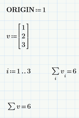

I want to sum up all the elements of a given range. see image

First, if you write
i:=0...2
f(i):=i^2
the "i" in te function definition has nothing to do with the range variable i. The i in the function definition is a formal parameter. You could make it anything you wanted.
f(xxyyzz):=xxyyzz^2
would work just as well.
If you then evaluate
f(i)=
if finds the last available definition of i, which is a range variable. A range variable is an iterator, and so it evaluates f(i) for each value of i. It therefore returns 0,1,4. You cannot do this though:
xx:=f(i)
because it returns multiple values (I would consider the fact that this does not give an error when f(i):=i to be a bug). You need somewhere to put those multiple values, for example a vector. So if, and only if, i is an integer sequence this is allowed:
xx[i:=f(i)
If the increment in range is not 1 though, then the vector xx will have zero's as some of the entries.

Which sum? In the attached, it works for range-sigma, because it is design to work with it.
But you have 3-sigmas: one for ranges (in the calculus toolbar), one for vectors (in the matrix toolbar) and other for expressions (also in the calculus toolbar).

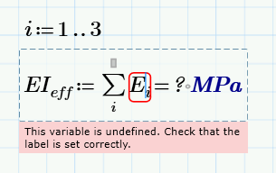

Can you tell me why this summation is not working? I have already defined E1, E2, E3 above.
TIA
Not without seeing how you defined the vector E (did you use vector indices, not literal ones?), how you set the value of ORIGIN (did you change it from the default 0 to 1?) and how your variables are labeled. We would need the worksheet to check the latter.
In any case it would be preferable that you open a new thread and attach your worksheet, too.
BTW, if your vector E only consists of the three elements, its easier to use the summation operator without any range i:

if you use a range variable in a function the answer is also a range of numbers.
No it's not. If I do
i:=0...2
f(k):=k^2
and then evaluate f(i) it gives me a series of answers, one for each value of i, because a range variable is an iterator. The result is not a range value though, it is just a series of answers displayed on the screen. It is not even possible for it to be a range value, because a range value is defined only by a start, an increment, and an end. That means it can only represent a sequence of values that are all separated by equal increments. It is not possible for a range value to represent the sequence 0,1,4. If you want to assign the values returned by f(i) to a variable you must do so explicitly, to a variable that is capable of holding multiple values (for example a vector).
V[i:=f(i)
I would reccommend re-reading Richards post on the 11-Oct-2010 21:53.
Have a look at the attached image. This is what Richard is trying to explain, I think.
