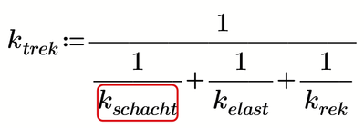

I need to write this equation this way >
however the left part can't be written like ( 1/k)
Thank you

As an EQUATION you should have no problems to write it in Prime
But if the goal is not an equation but rather an ASSIGNMENT/DEFINITION of variable k.trek, you would have to rewrite it
And if you are really lazy you can let Prime's symbolics do the job
