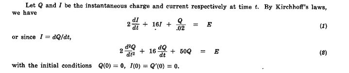

I tried using symbolic to implement without success. Any hints on how I can implement this. and later use Laplace transformation?

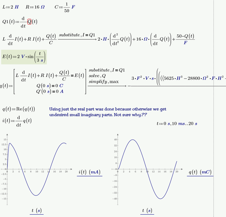

I added units and played around with Prime 9 new symbolic ODE solver.
It is not able to give a solution for a generic function E(t) but we have to define E(t) before we solve.
Nice, nonetheless.

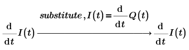

This like substitution seems to not work in this case:
Only manually if you make the substitution,..

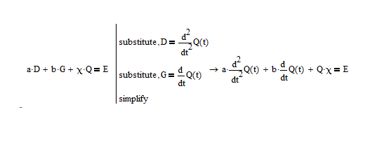

With the "substitute" operator you can do this for example:
(To:ppal)
It seems to work defining an intermediate function for the derivative
