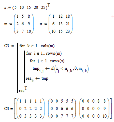

I'm having trouble creating a program with an if statement that has three ranges, i, j, & k.  Results would be a matrix with k submatrices each with i rows and j columns.  See attached.

(To:polarnaut)
Something like this?
Either you're too fast or I'm too slow!
Very neat use of vectorization!

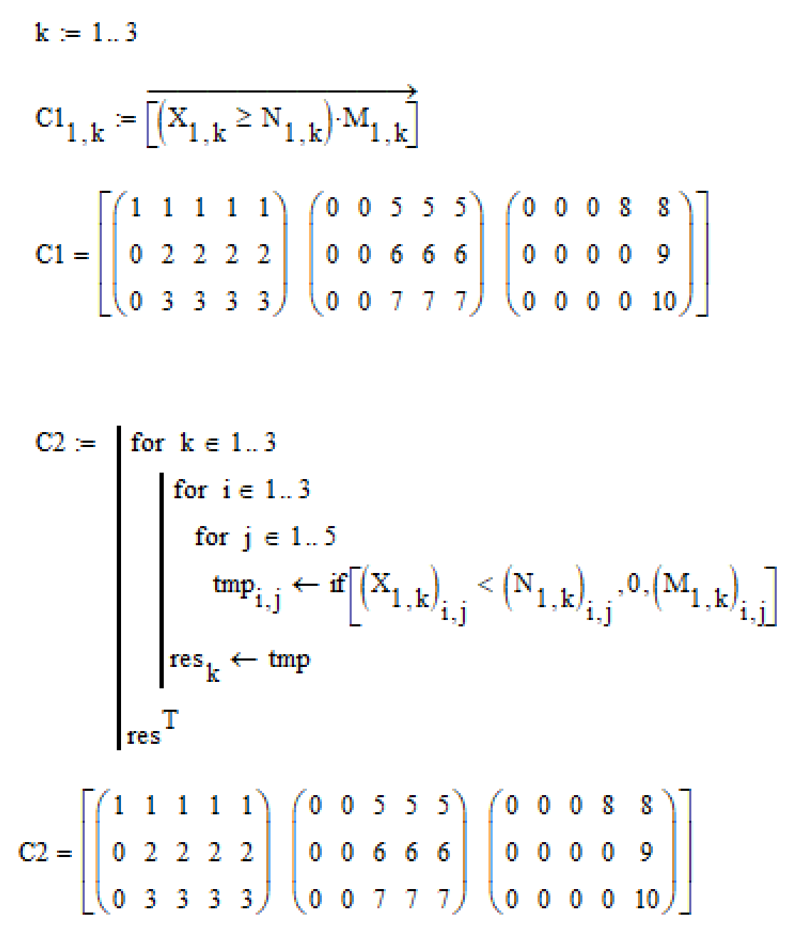

(To:polarnaut)
The data structure of M,N and X looks rather unnecessary blown up.
Maybe something more simple would do the job as well:

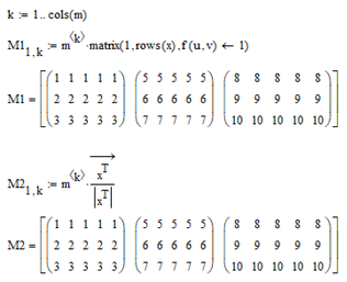

If for some reason you really need those structures M, N you could easily create it using one of the following methods:
