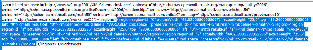

This is undocumented but it works.  Mathcad Prime files are a zip file of xml files but with an mcdx extension.  You can alter the file extension to "zip" and the internal collection of xml files can be read by winrar or other compression software.
Within the zip file is a folder "mathcad". Within this folder is a file called "worksheet.xml".  Within this file is a part called "regions".  Within this part are numbered regions that define variables and their values.
It is possible to construct in excel this part of the file with as many variable names and values you wish.  You need to change the id, top,  variable name and value on each excel row.  Enclosed is an example.  You save the excel file (worksheet only) as formatted text *.prn.  Then use a text editor to copy the text into the xml file between the <regions>  </regions> part indicators.  Rename the xml extension as mcdx again and hey presto when you open in Mathcad the variables will be there.

Thanks for the response! I am actually aware of manipulating the XML code of the MathCAD files in order to do what I am suggesting (I actually have an old MathCAD 15 python script that does what I am asking). I was mostly wondering if MathCAD Prime has a built in solution to this, or if anyone has found a more elegant solution than manually editing the XML code. As the other user indicated, I don't seem to be the only one looking for this kind of functionality.
