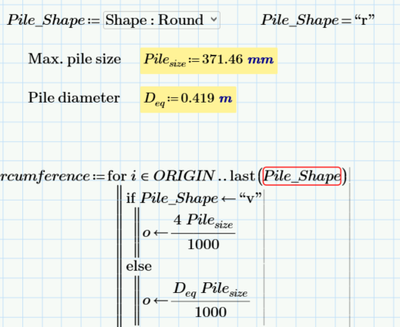

Hi there ,
I have created this combi table ( the sheet is attached )
I want to use the result in a easy program .. like if the shape is square use this equation if not use the equation for round piles
can you help me to do so? the easier program the better
Thanks in advance

@YA_10963798 wrote:
Hi there ,
No, sheet is not attached! And to be on the safe side you also should say which version of Prime you are using.

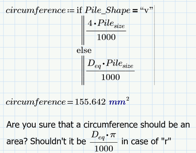

Why are you trying to use a loop??
Why not simply
Or using the if-function

@YA_10963798 wrote:
Hi there ,
Why not simply

I used the if function and it works . Thanks
