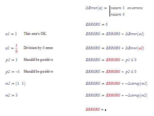

See if this helps you:
Essentially what it does is make sure that in the end, the variable ERRORS depends on all variables that you select. And if you only have errors that you can trap by reasoning (such as the examples with p1 through m2) it will tell you how many errors there are:
Note that you can place all Error checking to the right of the right margin, so that you don't need to print them.

That is not supported. You will have to check all pages for red items.
Another way is to have every result checked by a function (which you have to define!) that results in a value that you could check at the end.
Note that writing that function is not trivial. I can imagine what it might look like, but see enough problems that might occur, such as the problem where the check function itself returns an error....

Thank you, well, it doesn't really help since the file is really large and I am not willing to make an error request for every single variable. So, I guess, it is not possible but might be a good idea for a future release. Most of the competition has something for this.
