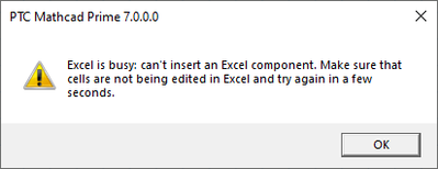

I'm trying to insert an Excel component in Mathcad Prime 7.0.0.0, and I keep getting an error that Excel is busy.  But Excel is not running.  I have checked the task manager, and Excel is not open.
Even in the list of background processes, Excel is not running.
Read Excel seems to work fine.

Unfortunately this is a very common error in Prime from the very beginning and it seems still not be fixed.
If you search this forum for "Excel busy" you'll find a lot of complaints about this very same bug and also a couple of workarounds you may give a try.
Maybe some of the answers here  help, otherwise i would suggest opening a support case at PTC support:
https://community.ptc.com/t5/Mathcad/Re-Mathcad-Prime-8-0-Excel-component-does-not-update-when-input/m-p/830087/highlight/true#M203249
https://community.ptc.com/t5/Mathcad/Unable-to-activate-Excel-component/m-p/104698/highlight/true#M41274
https://community.ptc.com/t5/Mathcad/Problem-with-Excel-component-being-quot-busy-quot/m-p/708593/highlight/true#M194042

I did search "Insert Excel error", but I guess I didn't go far enough.  Much appreciated.  Thanks Werner.

Hi
For me the only thing to do to solve this infamous Excel component - was to rapair Microsoft 365 !
After that no problem - Mathcad Prime 8.
