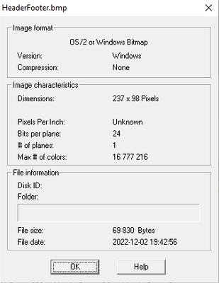

It's a format discrepancy that causes it, that I agree on. But it's not because it's an OS/2 format. Here is the info on the file from the OP that will not load (in Mathcad 15, and also not in Mathcad 11):
These are the properties of two other files that will load and show:
I guess Mathcad doesn't like bitmap files with a set value for pixels per inch.
