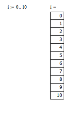

Has anyone managed to install MathCad 14 on Windows 11? I thought I had done it, but various things are not working. For example (this is from my from my Windows 10 installation)
On the Windows 11 installation i = produces nothing; i.e. no table.
Solved! Go to Solution.

Luc: Thanks for the suggestions, but the IT group here managed to solve the problem (after many tries and it was far beyond my capabilities). For others who may face this problem, here is what they did:
Looked up the program HKEY_CURRENT_USER\Mathlab and deleted any programs that we couldn't delete by uninstall. Next we downloaded Microsoft Visual C++ 2005 SP1 Redistributable Package 1 To make it compatible with Windows 11 and ran the installation. Installation was successful
https://www.microsoft.com/en-us/download/details.aspx?id=26347 for Microsoft Visuall C ++ 2005
Makes me wonder why this package is not on the list of software requirements....
