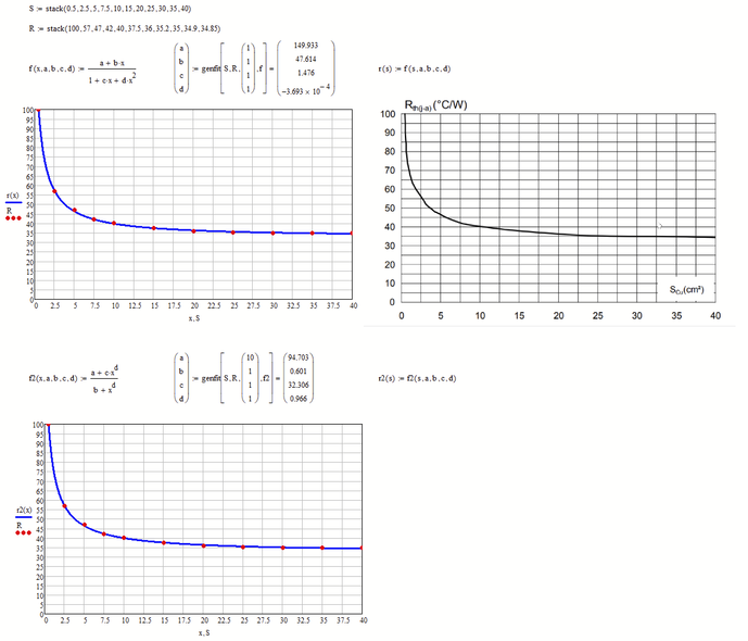

Here are two other models.
Both have the x-axis as horizontal asymptote and use just three parameters.
For playing around with different models I suggest you download the trial/evaluation version of "CurveExpert Professional". You can testdrive it (for I think 30 days) in full mode and then it falls back to a very useful mode with limited functionality which is always good enough for trying different fits for a given data set. CurveExpert will try to fit about a hundred predefined function models to your data and you may also define your own models. It sorts them for best fit and most of the times finds good guess values to come to a fitting result itself. In Prime you have to play around with the guesses yourself to get genfit do its job. Needless to say - the models above were found using CurveExpert Pro.

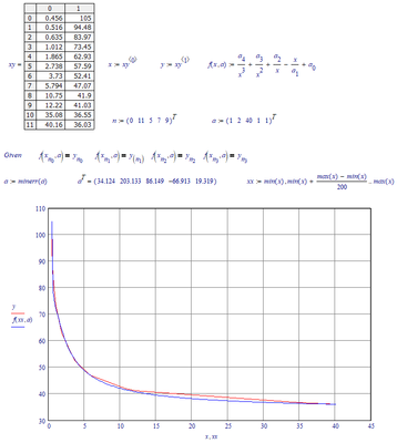

(To:xyz123)
Here is my 10 ct:
(I grabbed the data from the two vectors on the first page of your file, and assigned that to x and y, exported them using WRITEPRN and then imported it into Mathcad 11)
Fred_Kohlhepp
23-Emerald I
(To:xyz123)
Ok, I had to redigitize the graph since (as Werner pointed out) you didn't send your data.
Attached is a Prime Express file and a pdf of it.
I would expect that a log/log plot would present a straight line; it doesn't (perhaps an artifact of digitization.)  At any rate, a second order polynomial fit of the log of X and Y provides a reasonable curve.
  (The method of getting there is due to having only Express, so polyfit needs to be invented.)

Dear Luc, Werner and Fred,
very impressive overall 😮
I tried your solutions and attached the sheet here.
Also I included a screenshot from the original Data, but its the same as my both x- and y-arrays...
The Solution from Luc and Werner may have an issue in prime 3.0, or maybe I did something wrong? Please check. I would like to make your solutions work for me!
The solution from Fred works good within some conditions. The x-axis represents the copper area (for thermal cooling) and values bigger than 30-40 (cm^2) are practial. So within this this x-intervall the function is very good!
I played a little bit and increased the maximum x-axis until the function began to rise again (gradient rises again) and thats wrong. Anyway, for practical values its super fine 🙂

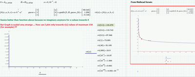

(To:xyz123)
I just noticed that you evaluated the two vectors anyway and as we can see the last result when we open a Prime sheet, I can copy the data myself and assign it to the variables.

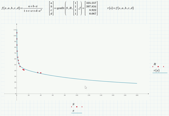

I don't know what happened in your attempt to duplicate my first approach. But when I deleted the region "r(s):=f(s,a,b,c,d)" and retyped it from scratch, things worked OK. So you may give that a try. Maybe the reason is Primes infamous autolabel "feature" - don't know.
Here is what I see after a changed the limits on the axis accordingly:
If x approaches infinity, r(x) appraoches zero - so the x-axis is the horizontal asymptote.
In my second appoach I realize that the new algorithm in Prime seems to be even more sensitive with respect to the guess values that the one on Mathcad. You found out about that yourself.
After changing the axis limits I guess this is the better fit of the two.
The graph approaches the value of c (approx. 10) if x goes to infinity.

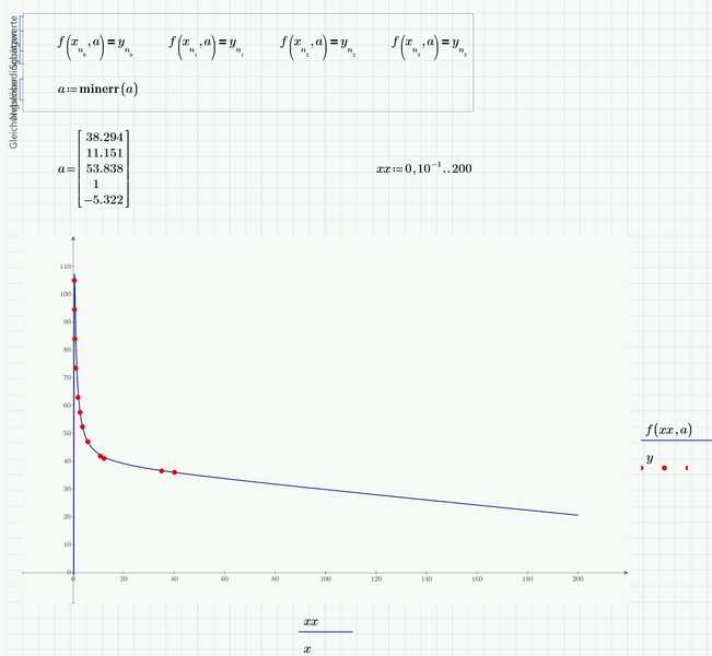

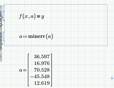

According you attempt to duplicate Luc's contribution:
1) You must put the constraints and the minerr command into a solve block
2) You must use vector indices! The ones you get by pressing [
When Luc writes xn1, both the n and also the 1 are vector indices!
This graph approaches minus infinity when x goes to infinity

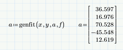

You may consider an easier approach without using the vector n , like
or you also can use "genfit" to do the job:
The values are a little bit different because in Lucs original approach only five data points (specified by the vector n) where considered, but now all 12 data points are taken in account.

(To:Werner_E)

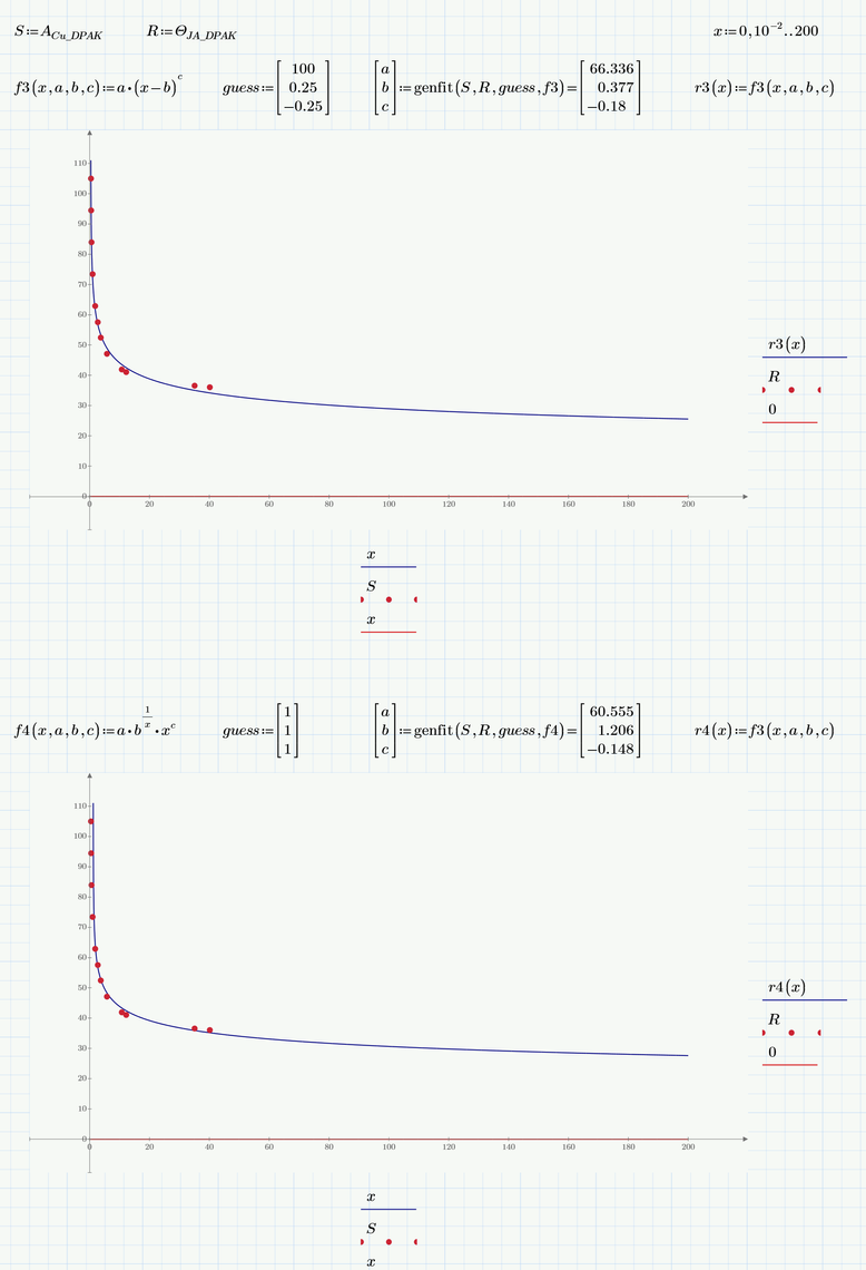

Thank you very much Werner,
this is a great help - from all of you guys. Thank you for the hint with "CurveExpert Pro". I was wondering how you obtain these functions.
I attached my current sheet - please have look!

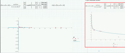

Basically it works, I can obtain plots, BUT:
- I have different results for my genfit function, although I used the exakt copy of your mathcad definitions.
I documented everything in my attached sheet, please expand the mathcad sheet so you can see the screenshots on the "hidden" right side.
- One of your solutions shows a completly different graph than the desired function... , please see "solution 2"
- In some cases I have to scale the y-axis properly, please see "solution 3", "solution 5"
Best regards
xyz123
(To:xyz123)
I mean this for "solution 2"
and this for "solution 3" and "solution 5"

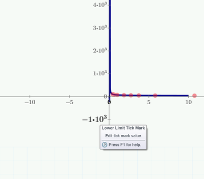

(To:xyz123)
To change plot scales, you can select and change the first, the second and the last value along each of the axes.
See the picture above, The red arrows point to the y-axis parameters, the green are for the x-axis.
Zoomed in on the bottom y-value.
If you change the bottom y-value to 0, and the second one (which is now 0) to 20, and the top one to 200, you get an axis from 0 to 200 with ticks every 20.
It is great to see how intuitive this was designed...

(To:xyz123)
Luc already pointed out the problem - Primes autoscale usually does not do a good job and you will have to manually tweak the axis values. This is what I was talking about when I wrote about "changing the axis limits".
You can change the first, second and last value on each axis. And yes, its absolutely unintuitive and can take quite a while and may be very demanding to catch those tiny values with the mouse. A shame for a company like PTC to deliver such a crap.
Furthermore I usually used the so called quickplot feature. By this its meant that you can plot a functon f(x) over x without defining x. Prime will automatically chose what it thinks is an appropriate step width and ... it will always chose the range from -10 to +10 for x. Thats the reason you may see the curve  stop at x=10. As soon as you manually set the upper limit for the x-axis to a different value, the quickplot will adapt itself accordingly.
An alternative to the quickplot is to define the x-values as a range. This may give you a better and more intuitive control. Its also a good idea to name this variable differently and thats the reason Fred used xx as variable name for the range and consequently did not plot f(x) over x but rather f(xx) over xx.

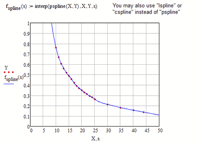

DJF
(To:xyz123)
B splines are often useful.  While they can get you into trouble, they're often a quick way to take a lot of data and get a quick interpolation function (provided you stay within mathcad, can't really export it).  See the ptc help example here:
https://help.ptc.com/mathcad/en/#page/PTC_Mathcad_Help%2Fexample_least_square_spline.html%23wwID0EYCIS
4.0 and pdf attached

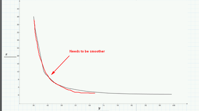

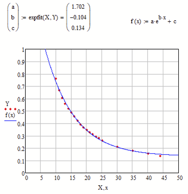

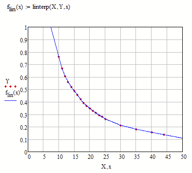

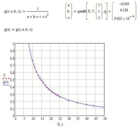

Hello all,
could you please help again to interpolate smoothly the following datapoints?
X-Axis   Y-Axis
10 0,76
11 0,66875
12 0,60625
13 0,56
14 0,519
15 0,4875
16 0,456
17 0,42
18 0,39
19 0,36875
20 0,348
21 0,328
22 0,312
23 0,29375
24 0,28125
25 0,263
30 0,2125
35 0,1815
40 0,15625
44 0,1375
Best regards
(To:xyz123)
@xyz123 wrote:
Hello all,
That depends on how you would define "smooth interpolation" and what you would need the interpolation function for. For many cases a simple linear interpolation like the one shown in the next picture would suffice and be as good and suitable as any spline interpolation.
It may also be that you are looking for a regression function. If thats the case it would help to know more about the data, what process it stems from and what kind of function its assumed to be underlying.
Here are two different examples for a regression and you always may fit your own function type to the data using Mathcads genfit function as shown in the last example.
