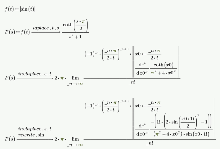

Anyway, I'm having trouble understanding why the invlaplace function won't evaluate as shown in the attachment. If I remove the absolute value sign, then it all works as expected (am I just running up against a domain issue and need to use the "assume" keyword.....or something......?)

Looks like what you demand is too hard for the symbolics in Mathcad.
Its also too hard for Prime's symbolics:

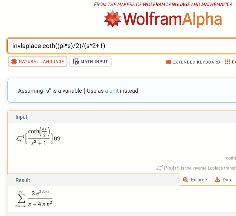

And Wolfram Alpha isn't able to come up with the desired result |sin(t)| either:

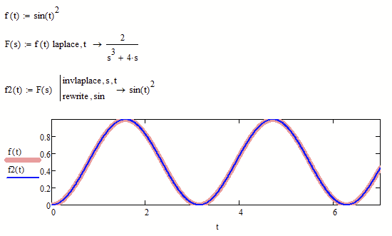

Much more difficult like a simple function like the squaring

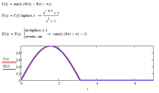

(we see "1" instead of "Phi(t)" because the result of course is valid only for t>=0).

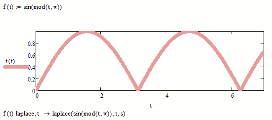

We could try to rewrite the absolute value using the modulo function, but unfortunately the laplace operator can't deal with the modulo function
